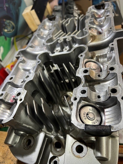

Installed a new rebuilt head on my 73 Z1 and I'm getting what sounds like loose vale lash noise. The cam specs are .005 to .006 so I set them to stock at .002 to .004 and it was slightly quieter but still noisey. Reving it up it gets real loud. Didn;t sound like that with the old head and nothing else was changed. The valve keepers are mostly right at flush with the top of the valve stems as they had to be ground for clearance. Would that cause the noise? Any thoughts or suggestions?

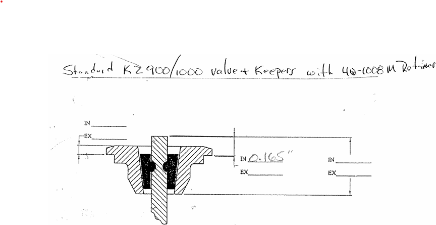

If your keepers are flush with the valve tip how about your retainers. I would make sure everything is below the valve tip.

I had one bucket that was not sitting strait when I first assembly them, I found that the retainer was not absolitly strait due to the springs surface and the sterm was almost flush,, I found titanium retainer that were thinner and expose the stem a bit more.

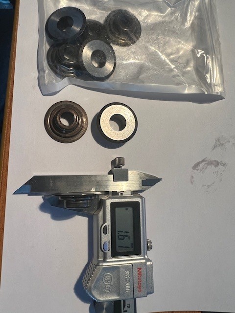

Kaw boy, Are your kibblewhite retainers shorter than the stock ones? They appear to be flat on top vs the flat / taper on stock ones. Looks like they would make more clearance.

This awnser came from Z1 Entreprises: The thickness of the retainer where the spring sits is 1.4mm. The middle section is 3.3mm thick and the overall height is 7.6mm.
FromThis email address is being protected from spambots. You need JavaScript enabled to view it. > :
I had the original retainer machined to 1.6 mm where the spring sit. I'm not sure of the original thickness.
