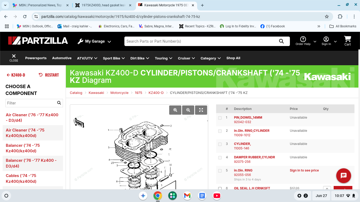

Thanks. So I’ve taken it apart and there are no o’rings fitted at all.
There doesn’t seem to be any pocket for them either. Do they just sit inside the gasket?
ta

Ok thanks, I’ve ordered some o’rings so that should sort it hopefully.

See page 36 in the factory service manual.

Just taken the cylinder base off, there are no o’rings there either! Just lots of silicone everywhere, seems to have been some bodging going on.
