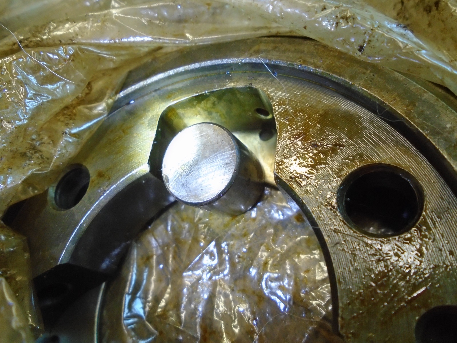

Found another problem. I removed the alternator cover the hooked a battery up to the starter with transmission in neutral. The starter clutch gear, the large one rotates freely on the shaft and the motor does not turn over.. Looking at the factory service manual is that some kind of clutch between it and the alternator armature? If I need to disassemble it they call for a special tool to pull the armature, is it necessary, or can I make a puller?

Might be the starter, might be the solenoid, might be the sprag/roller/pin and spring assy? Oil selection has no bearing/influence on this, synthetic or dino, no relevance. Depending on your circumstances, do you hear the solenoid clicking? Is the motor/starter turning? Too often persons buy those "roller" kits to renew the performance of the starting feature. You're wasting your money, those components rarely fail. It's the "RAMP" within the compartment where the BIG rollers gets bitten with repeated wear and no longer sinches down the BIG roller. Just FYI, if you're running an air-cooled engine tucked back in a compartment it's life expectancy is dramatically shortened. That's probably why they ran the GT750 Suzuki engine, watercooled.

Yes wrong terminology I meant the rotor. I've been using Mobil 10-40T so that ight be part of the problem. I currently have the motor in a stand and hooked it up to a battery and the starter motor spun the starter gear freely so I'm assuming the starter clutch is bad. Finally figured out how to pull the rotor off from posts here and looking at the manual(Clymer appears rather hopeless) and partzilla has starter clutches. I'll cover the rotor and put the cover in a plastic bag also. Thank you

Asphalt- the starter is running and spinning the "ring gear" for lack of a better term, but the crankshaft isn't turning. So to me the starter clutch appears bad, I thought that maybe I tried to start it when it was in gear and broke something as when the chain sprocket came off I had no idea what was going on and tried to restart it because the motor died at the time. Yes I'm having cooling problems as a PO had set up a weird and miss engineered cooling fan arrangement. I have an oil cooler capabe of cooling a 350hp motor and still running oil temps in the case in excess of 250f. I'm working on a forced air cooling solution. I bought the car knowing I had a development project The cost was a small fraction of what well developed cars of the period cost.. For example a Lotus 23 from the 1960's is about $125k and a motor rebuild when required a minimum of $25K.

Think You figured it out, part represented earlier. Also check, while apart, the wear area, on "ring gear", it's one assembly. Note while those ring gears look similar from the Z1's thru end of J engine production. The J used a different/bigger OD at crank end so subsequent changes were made to ring/caged needle bearing/(2) thrust spacers and thrust rubber. That Lotus, Esprit in my case, is one i've always wanted!! I do the carbs for my Friends Lancia's, good for a change of pace, ha. Good Luck with Your Project!!
