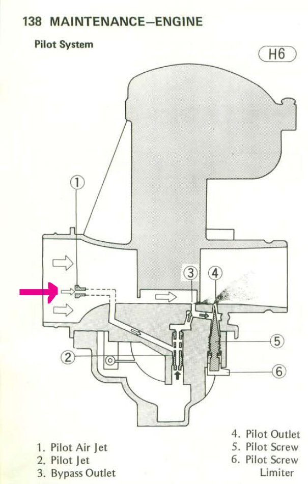

It must be a carb problem. Maybe some internal passage plugged in the pilot circuit.
If you shoot carb spray into the intake throat passage shown, you should see it come out the carb throat at the pilot fuel screw (4)

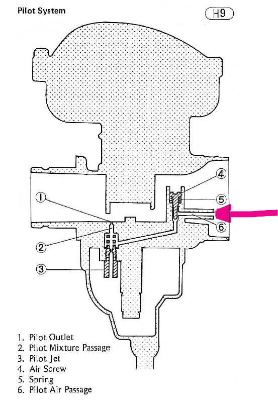

Just pulled the bowl. Can confirm the port is clear by spraying carb cleaner

If the cylinder fires on starting fluid, the problem is fuel supply, not ignition or mechanical, like valves. It's concerning that you cleaned the carbs without removing the pilot screws (or did I read wrong?) Incomplete carb cleaning is the number one mistake that people make when restoring a bike.

I cleaned the carbs in my ultrasonic cleaner awhile back. Had them all apart. Just now, to verify the pilot porting was clean, I removed the bowl off of carb 1, removed the pilot jet, and sprayed carb cleaner into where the purple arrow is on the diagram attached. Spray came out at spot 3 on the diagram. I then swapped the pilot jet itself with the one from carb 2, reinstalled, and same issue of cyl 1 not firing. I will take back apart and verify spray comes out at spot 1 since overlooked that.

you saved the day and the last 5 weeks of me being baffled. that port labeled 1 in the diagram you sent for the TK-22 carbs ending up plugged up. I was able to get a small tip cleaner in there with it bent and pop it into the port from the inside of the carb, broke up whatever crud was in there and got carb cleaner to spray through. I would've never know that port existed or to even look there🤦♂️. She runs on 4 now!
