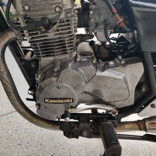

Sorry to say, but your hex bolts are looking more like allen head screws, right.......
