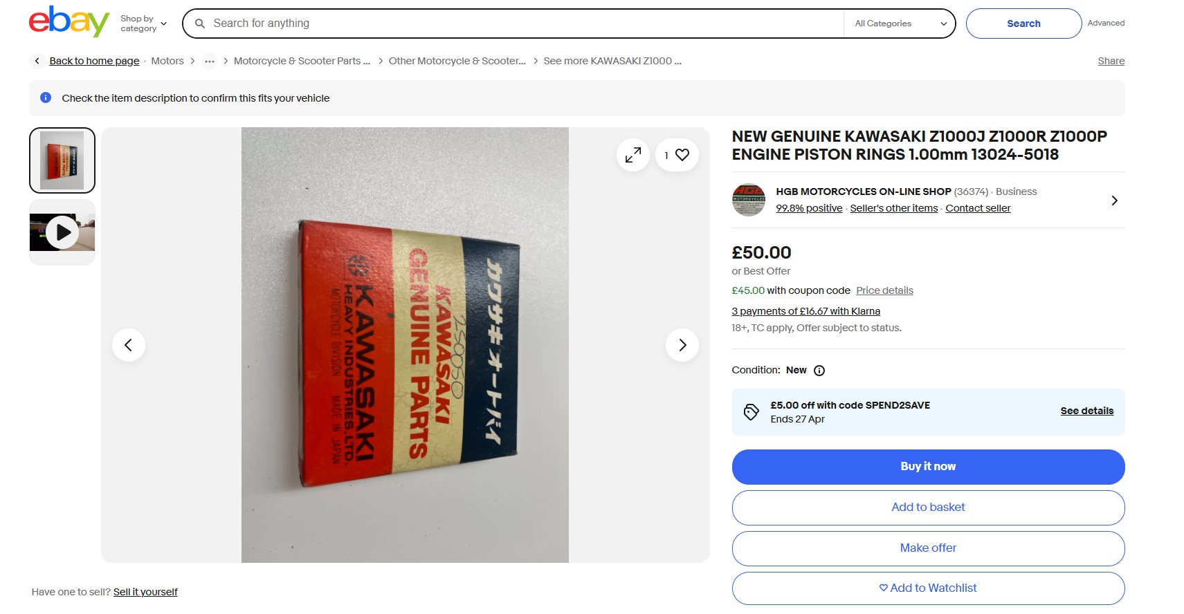

Situation just got a bit more complex. I am working with a set of jugs that came from evilbay and appear measure to be standard bore and in quite good condition. So we checked my "old" pistons and they were made by ART who is apparently a large supplier in Japan that are 1mm OS. A quick(quite unknowing where to look) didn't show that any new rings would be available as the pistons are in excellent condition. The rings measure 1.0,1.2.2.5 and the pistons have a 100 stamped on the top. Any suggestions for new rings would be appreciated.

ART are the OEM Kawasaki pistons.
You need Genuine Kawasaki oversize rings.

There is a supplier in the UK listing these (don't know how many he has but there is an OEM part number) IMD only list +0.5mm

Thanks Wookie, questioned the supplier and they said they were correct, so the rings are on the way.. Two questions as my local machinist whom I trust is not primarily a bike guy. First what is the recommended piston to cylinder wall clearance? Secondly, can we resurface the top of the jug set and how much?
