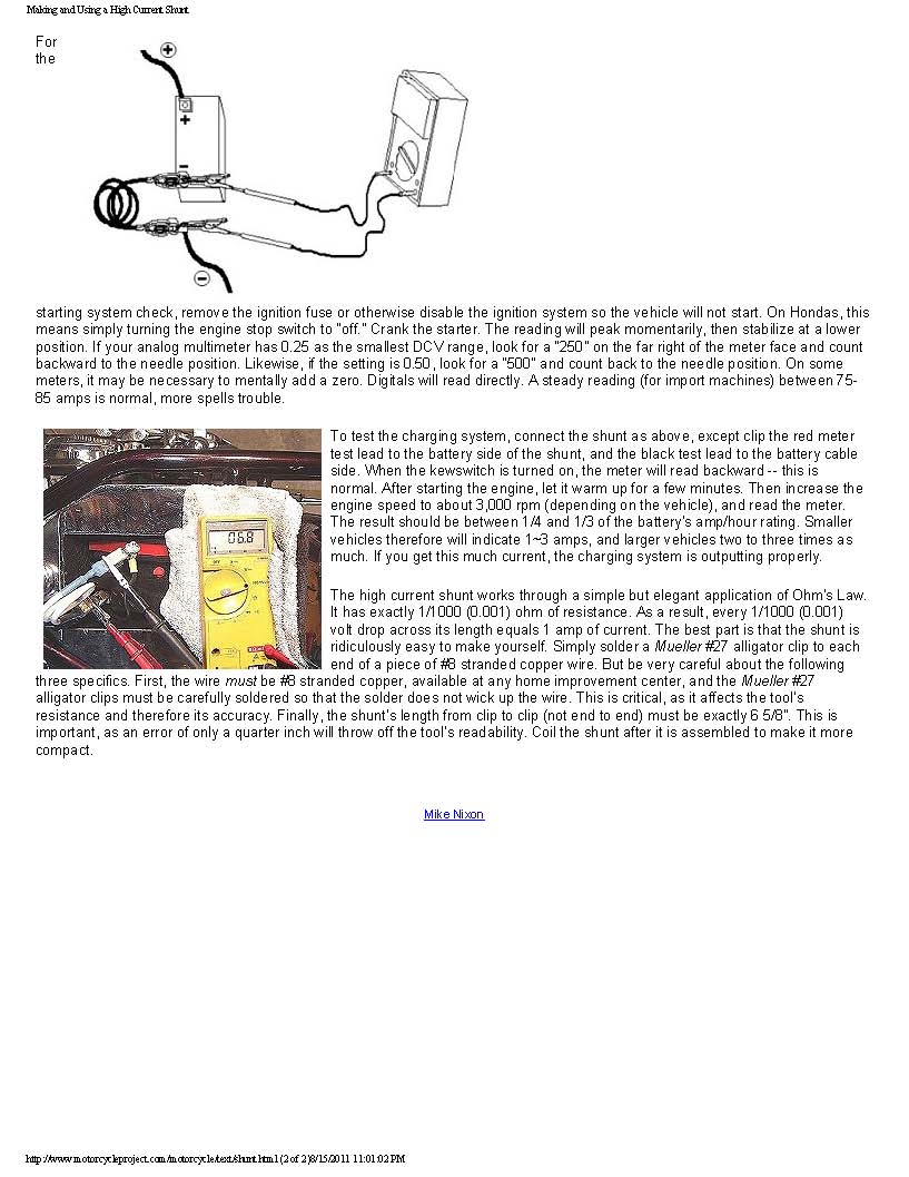

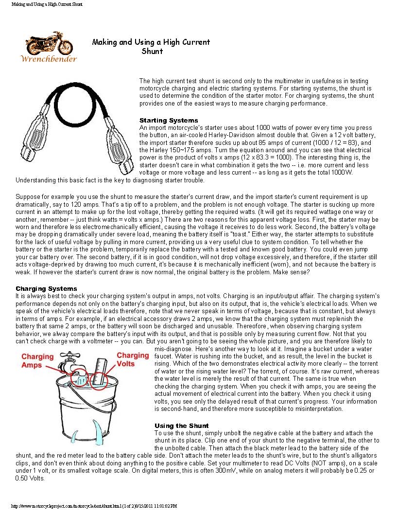

OK, so having read your other post re headlight issue when cranking the starter, it could be the starter or the battery that is causing the issue. I have found this Mike Nixon post to be a great home made tool to check the starter and the charging system. Keep in mind that the starter is by far the largest draw on the entire electrical system on the bike.
