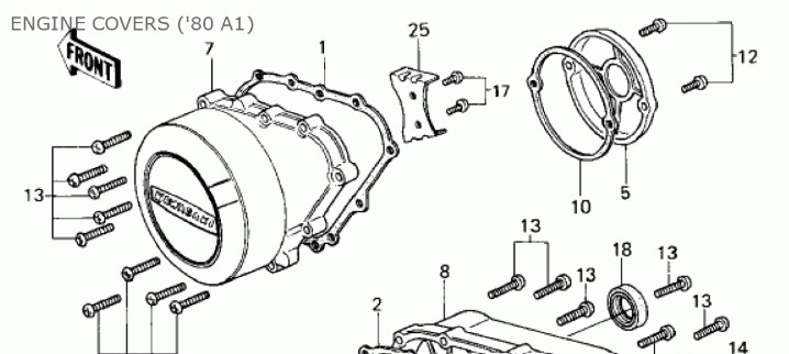

If you re-assemble everything (without the starter chain fitted) and kick/push start the bike how is it then ? noises often sound worse than they are (the inside of the motor is like an echo chamber)
Is there any sign of the chain trying to eat the guide #25
