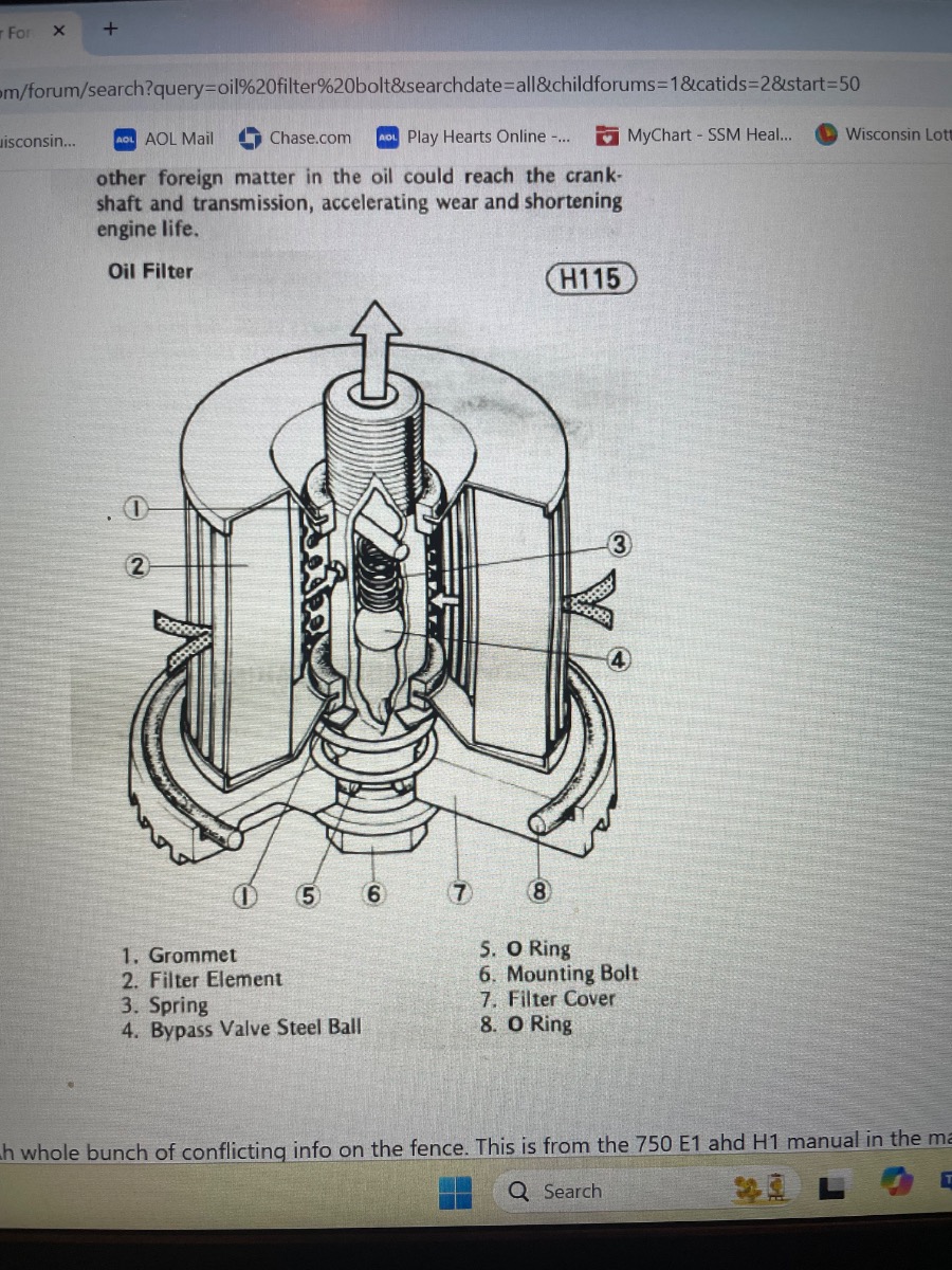

Thanks for replies. That bolt with four holes is the one I have. I saw the following member post with a valve in the bolt (spring, ball and pin). I’ll use the four hole bolt that was in the bike, 1000 A2.

The picture you have posted with a relief valve in the bolt is for a 750 E1/H1 (totally different motor)

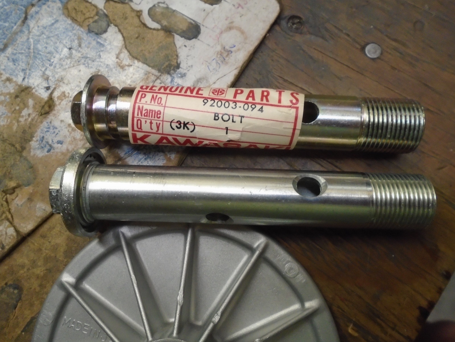

Yes, as everyone mentioned, You're gathering information from the wrong model. During the run of the Z900/1000, 1972-1980, TWO types of oil filter cover assemblies were used. Neither used a check ball within the filter bolt. Early version had the o-ring within the cover, later was underneath the head of bolt. And covers were suited differently for the two styles. Note in picture, early one is in top of photo with it's parts tag laying on it with number. McDroid is correct about the superseded "later" style too. But that's just cosmetic for the head of the bolt and maybe finish plating.
