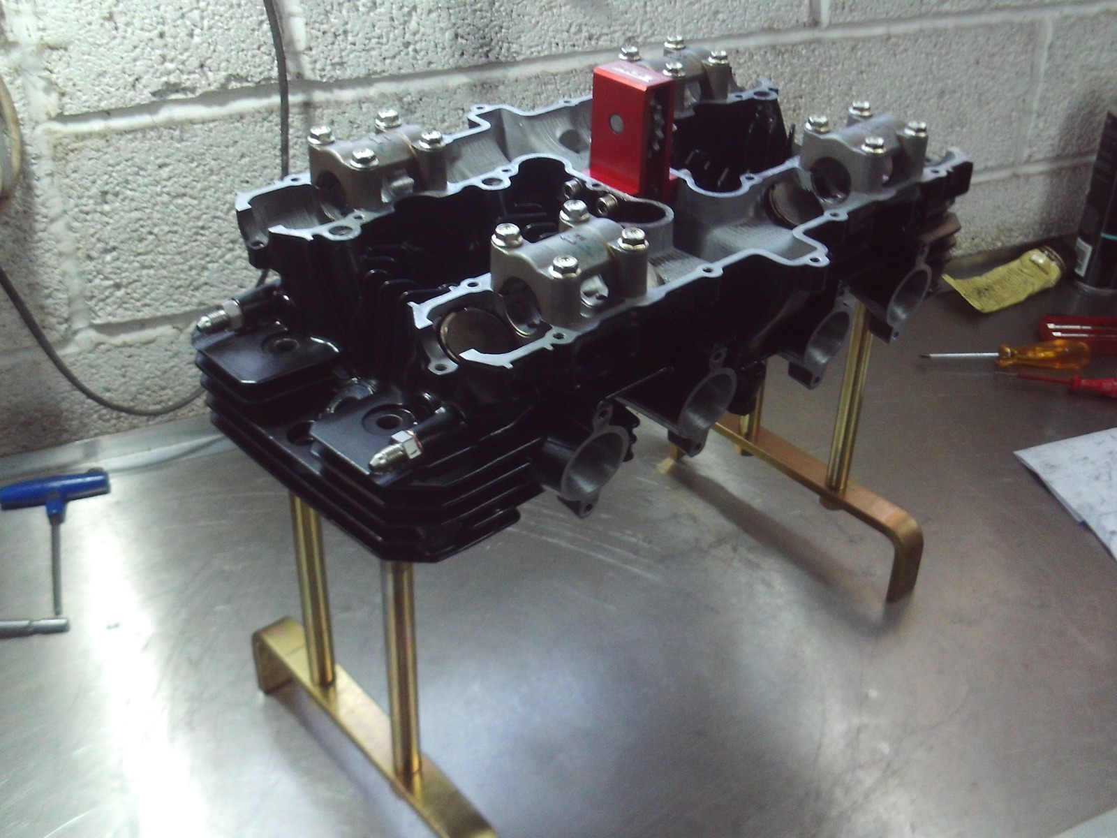

This is a J head which simply needs the top idler modification ( the red bit ) for it to fit any earlier Z9/1000 engine.
The stock 40cc combustion chamber volume is 4cc larger than the earlier (36cc) heads so will need steps taken to correct this such as skimming it approx 1.3mm or using higher comp pistons .

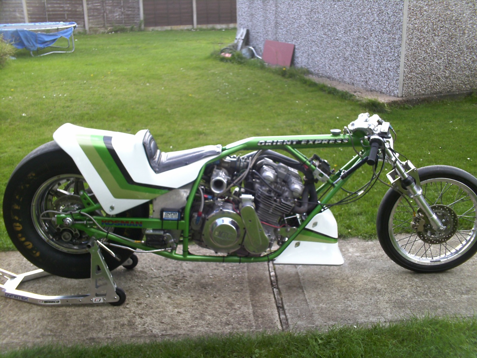

This head is now on my recently completed Racecrafters build which can be seen elsewhere on the forum.
It is 1075cc and i used 12-1 comp rated wiseco's to get the actual comp to around 10.5 to 1 and the head is ported with 90% throats and 32mm / 37.8 mm stainless valves.

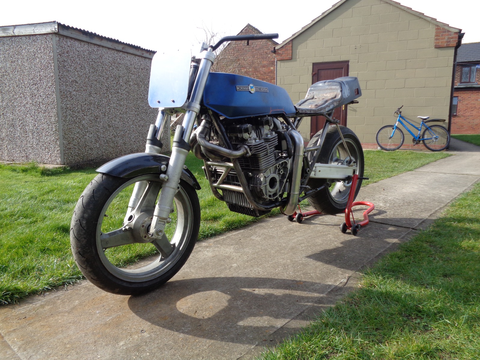

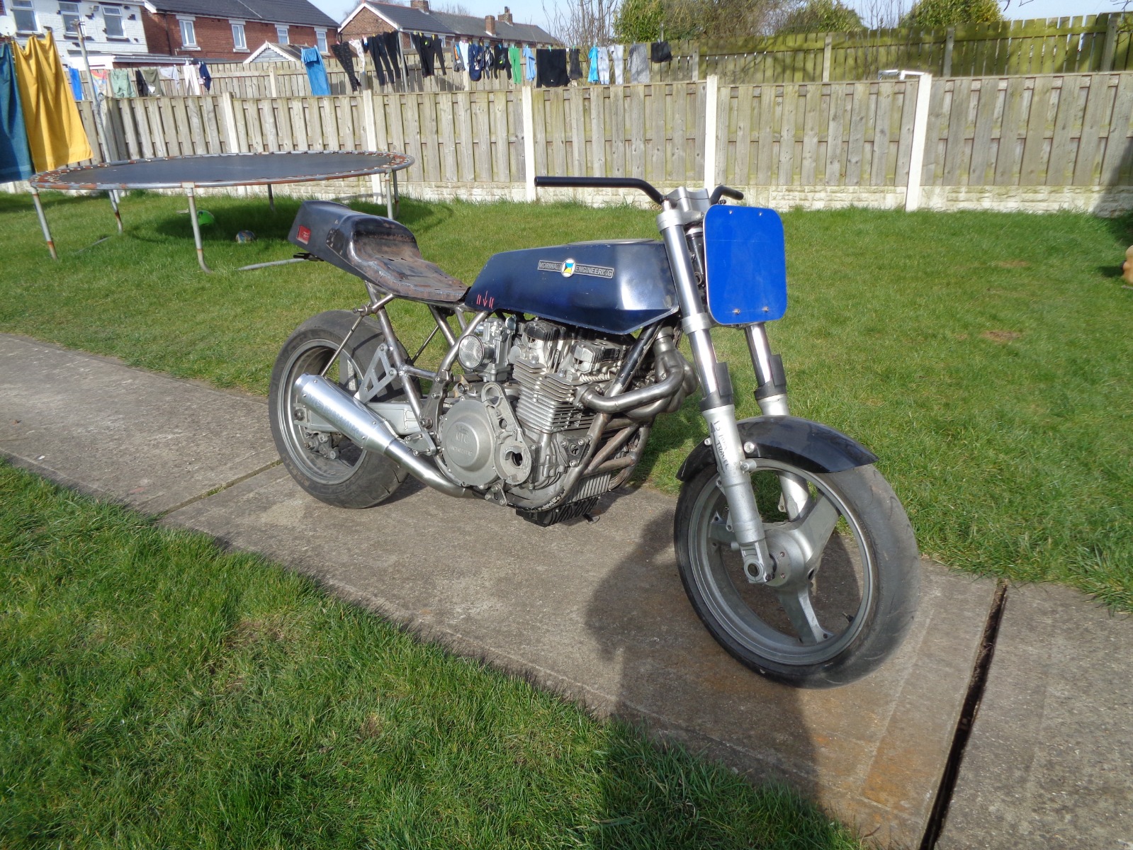

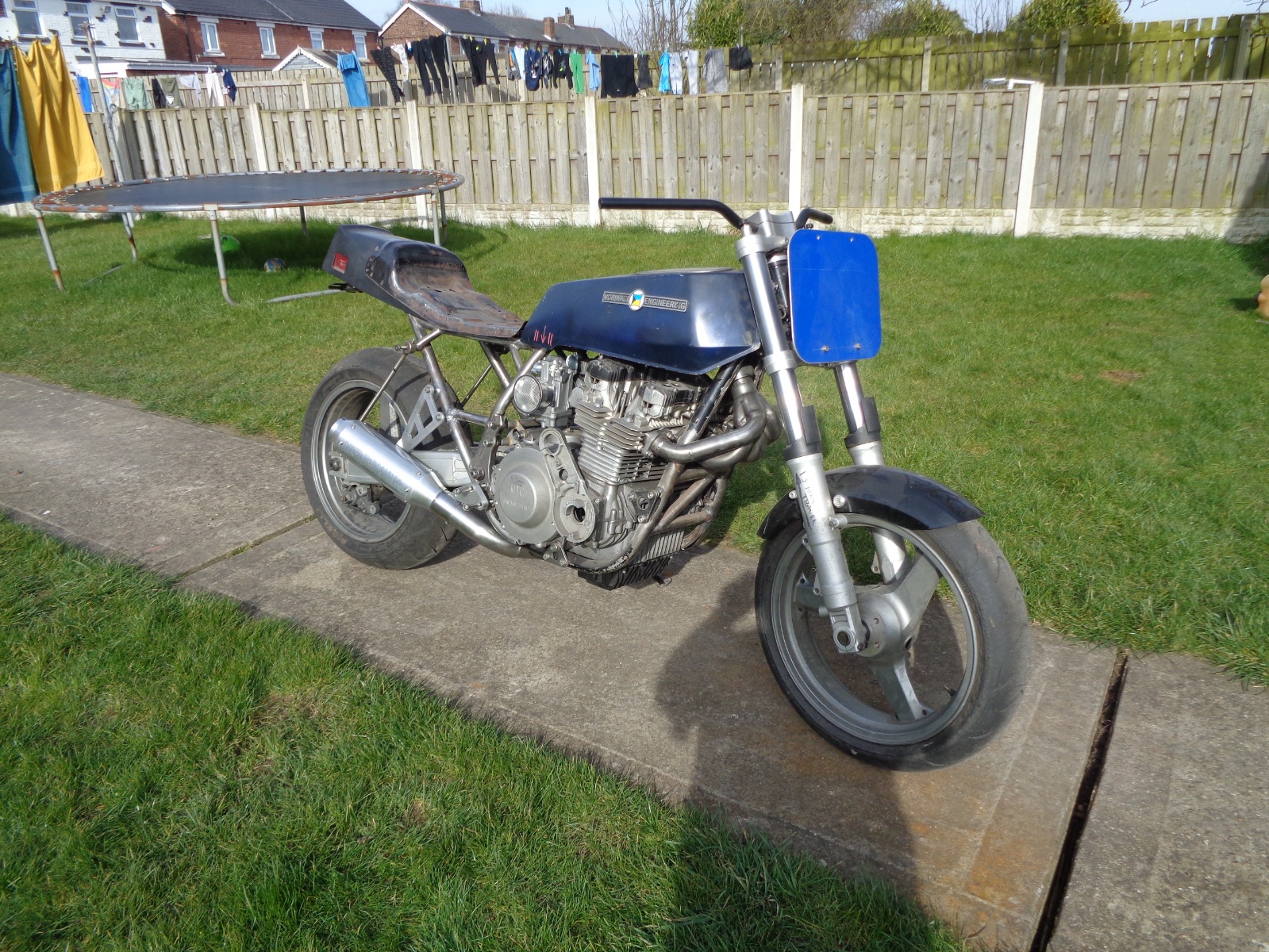

The  pics in the second post is my current turbo build which will also use a J head.
This is also 1075cc and i'm using 10.25 -1 wisecos and a barrel spacer of yet undetermined thickness to get the comp down to around 8-1.
This will use 33mm/37mm valves with 90% throats and the porting focused on the exhaust side .

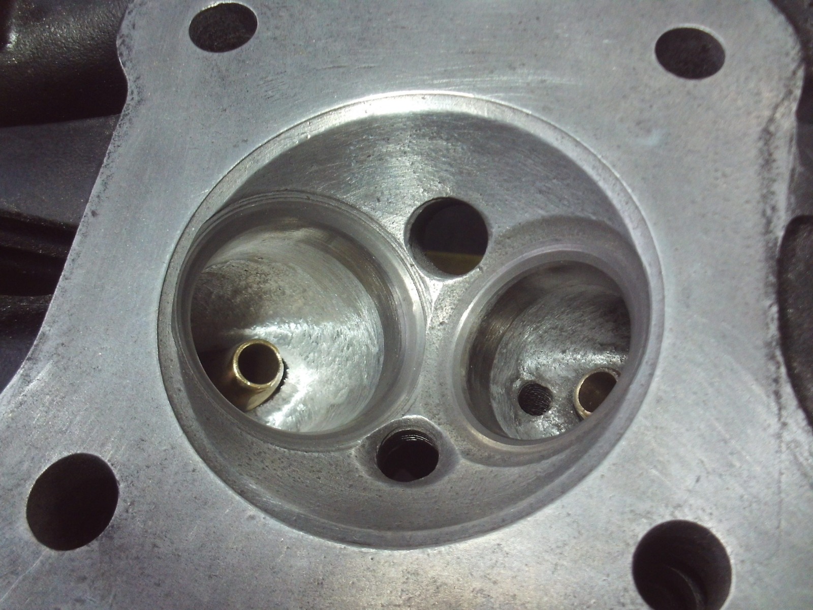

Hail 1015!! I know expertise when i see it, what do does that 90percent on porting mean, i still Need to learn!

Just fitting bigger valves won't show any benefit unless the throats ( the part of the seat the fuel mix encounters just before the 60 degree cut of a normal 3 angle valve job ) are enlarged too for increased flow and then blended into the bowl .
Depending on application the throat is enlarged by a percentage of the valve diameter and going too big can actually reduce the flow rate to less than the stock head.
With a two-valve head, 90% of the valve diameter is ideal for all-around throttle response, acceleration and best average power.
If your throat goes over 92% valve diameter, you begin to lose horsepower quickly so 90% is a nice safe number for general home porting especially if you haven't got access to a flow bench.
This is 90% on the J head.

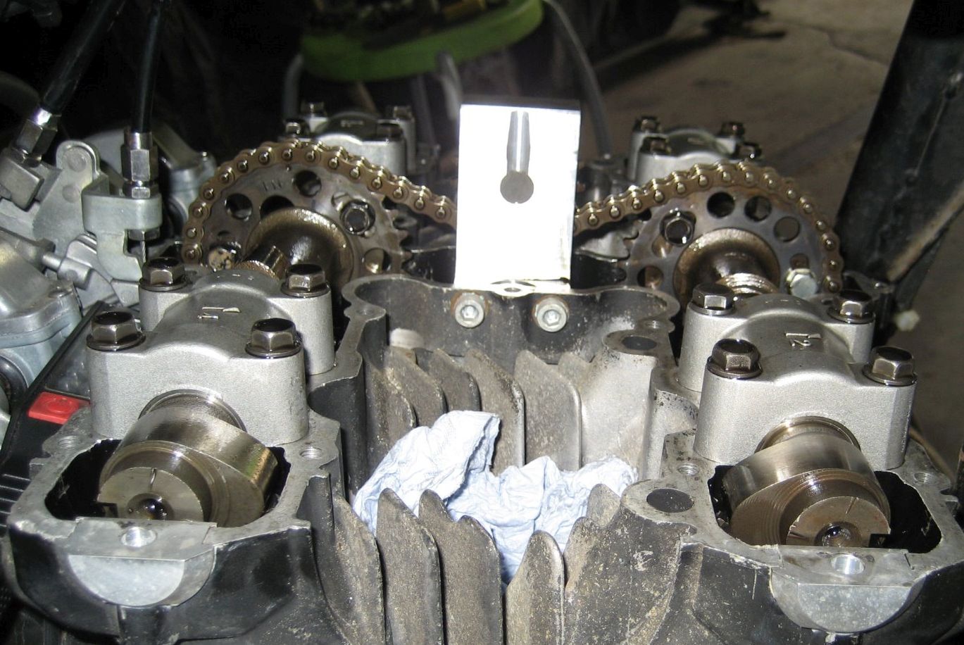

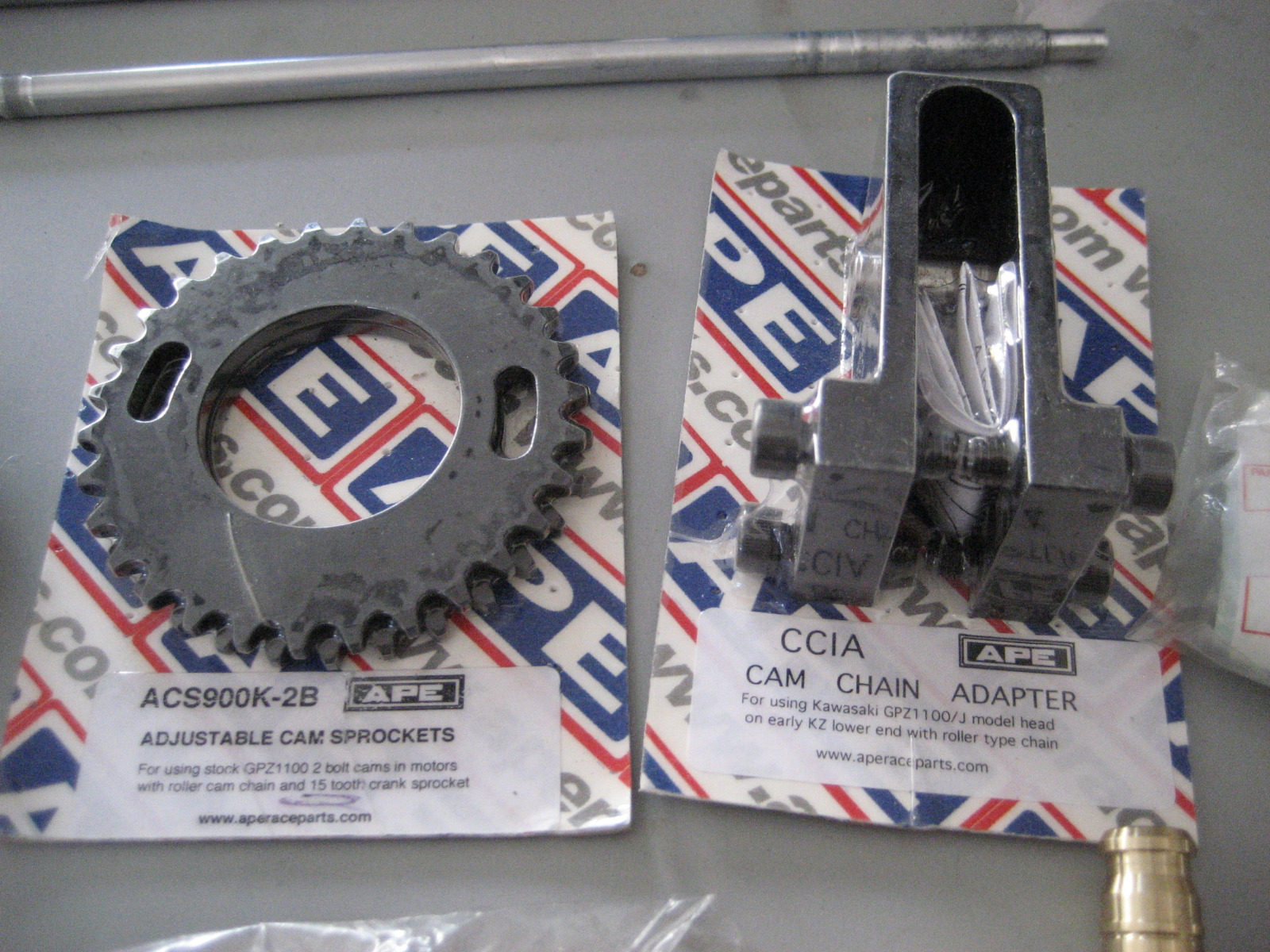

I´m running a ported J head with UT cams and adjustable UT cam sprockets. You need allen head screws to fasten the UT sprockets.
Hex srcew heads will collide with the roller cam chain links!!!
Pic shows Z1 cams and adjustable sprockets. As ZED1025 mentioned, on stock piston setup you get only 8-1 compression = turbo setup.
