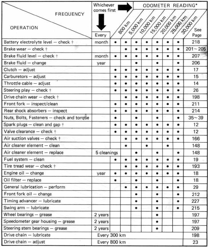

- Posts: 8278
- Thanks: 2725
Re: Low compression across all cylinders
21 Mar 2025 17:19
