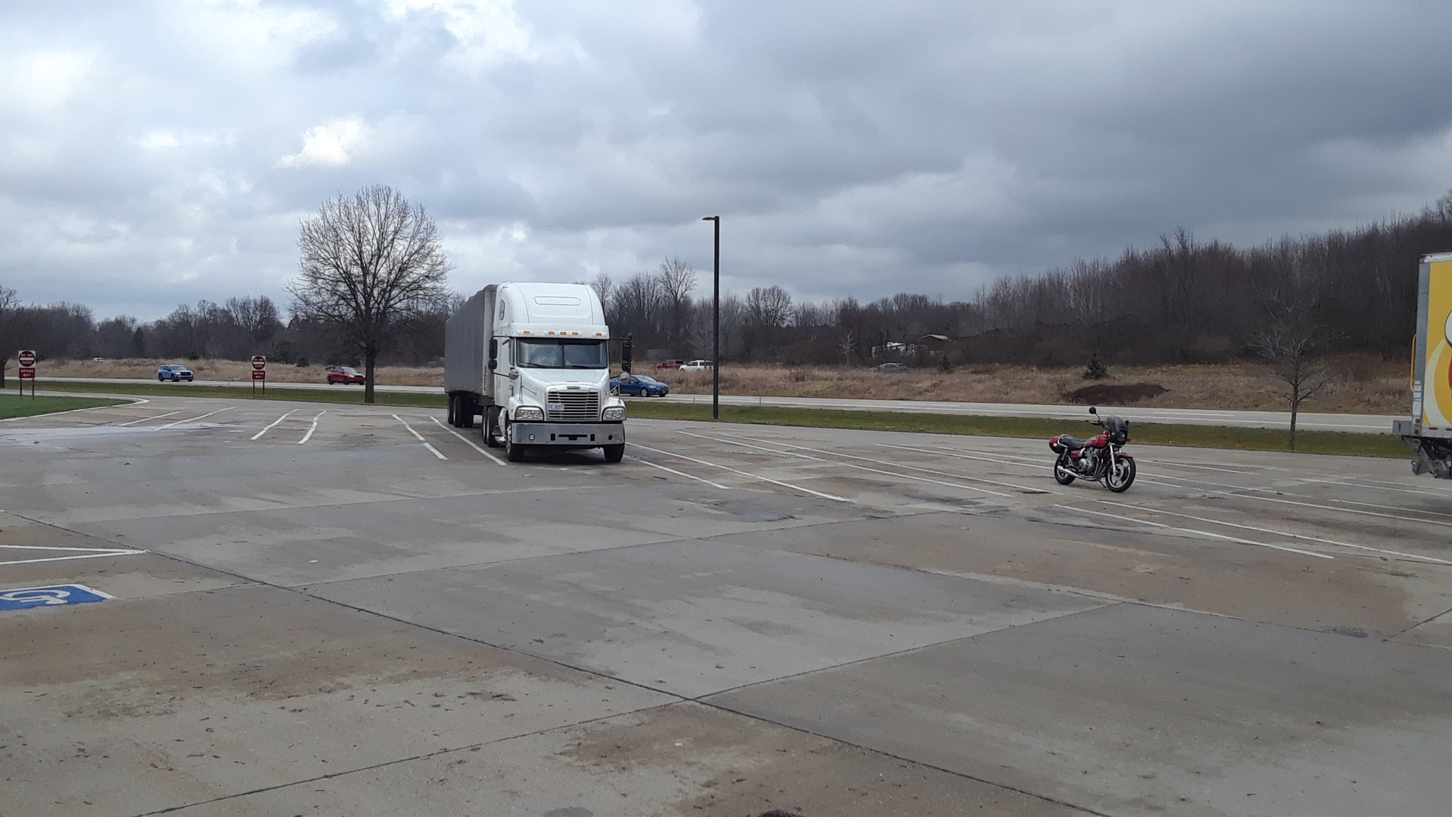

I felt some slippage when I stopped after exiting the highway during my oily first/last ride in December.
Then I got back on the highway for what wasn't a quick ride home.
Fortunately that rest stop was just a couple miles away.
Hmmm...my back tire was probably oil-coated already when I pulled off the highway to turn around.
