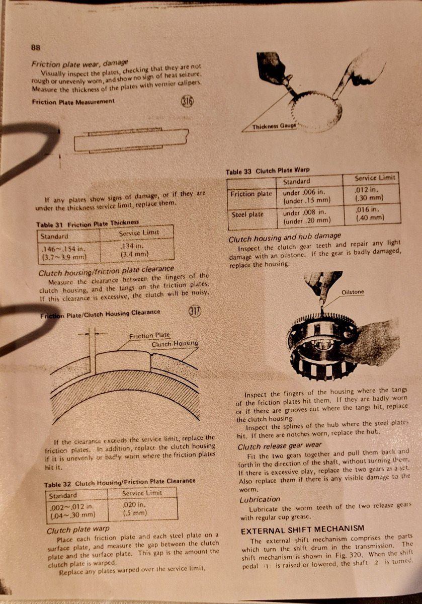

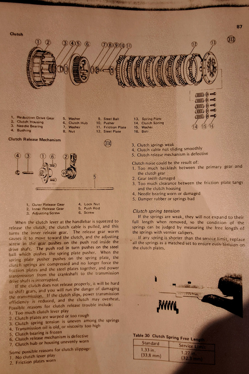

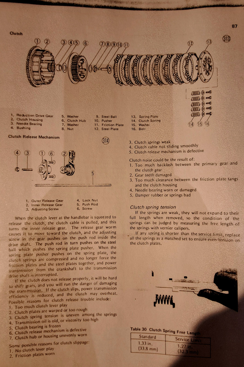

when you first open the cover i recomend having new friction plates (and metals) ready. you will probably need a new gasket anyway.
if you dont have a manual i post 2 picks how to measure the disks and springs for service limit. It is from 1976 kz900a4 manual but i think the kz1000 has the same clutch
