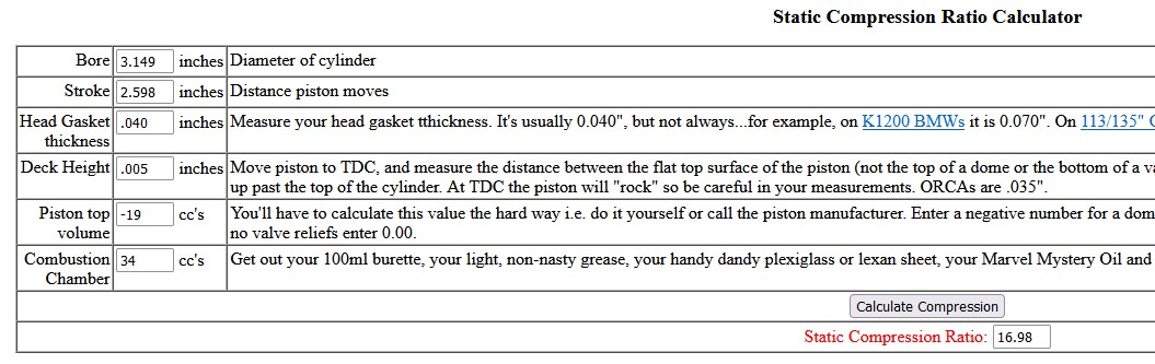

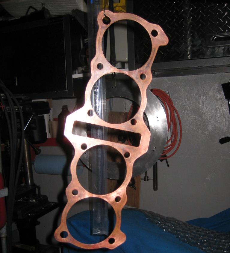

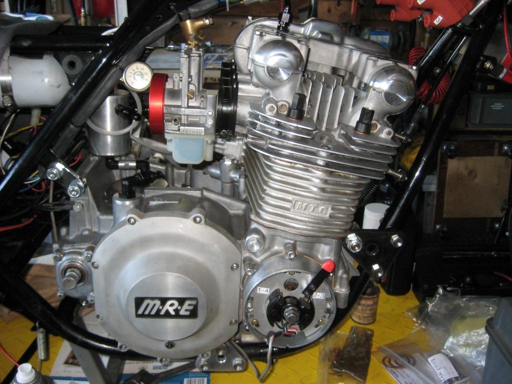

02 Feb 2025 16:44 - 02 Feb 2025 16:49I did a 1327cc drag engine a few Summers back, but it did not need any extra milling on the big block (MTC)urankjj post=908559 userid=50341I do know that a copper base gasket was used on my 77-KZ1000, (1327 build) back then, and I think that the block had to be milled because of the copper gasket for top end valve clearances.?? I don't know for sure, it's been many yr's...
From bench racing talk I heard the old APE blocks may have needed some extra work, just not sure what as it was never specified in the shit talk
I had to use 4 x .015" copper base gaskets to set my deck height. Not the greatest plan to get to -.005" deck, but it worked at the time. Pistons were previously cut down for street by PO, but I shaved the head to make up for it.
