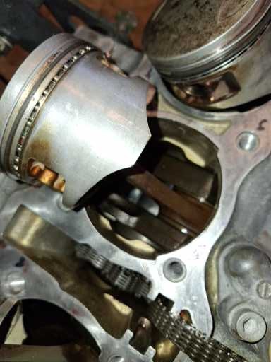

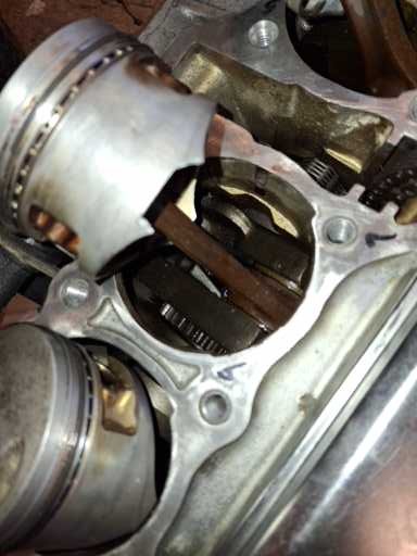

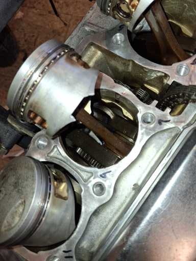

I was putting a new cylinder head gasket on my 81 KZ1100 but I broke the tail off one of the pistons. I ordered a new used one, it never showed up. I ordered 2 more new old stock. When they got here they were 107 instead of 961. Can they be used together? They seem to weigh the same. If I can find another 961 (my 1st choice) I'll put it in. But if the I find 2 more 107s (2nd choice) will they work? Or would my 3rd choice work?? Mill all four of the original pistons down. This is because I have seen some really short pistons in engines of that era. I mean almost 1/2 as tall.
