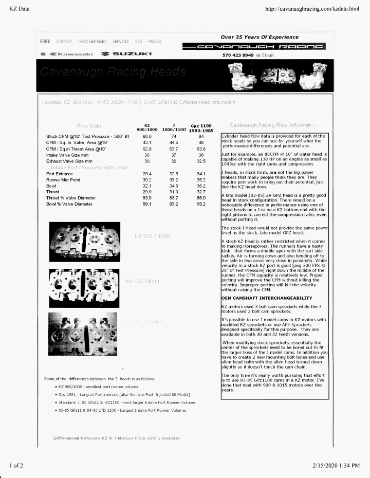

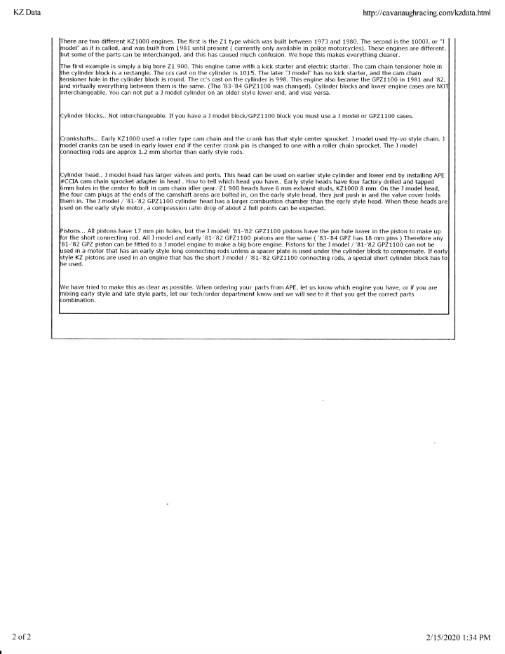

Re: Z1000 A1 cylinder head 8mm stud bolts vs Z1 900 cylinder head 6 mm stud bolt …
21 Jan 2025 12:21
