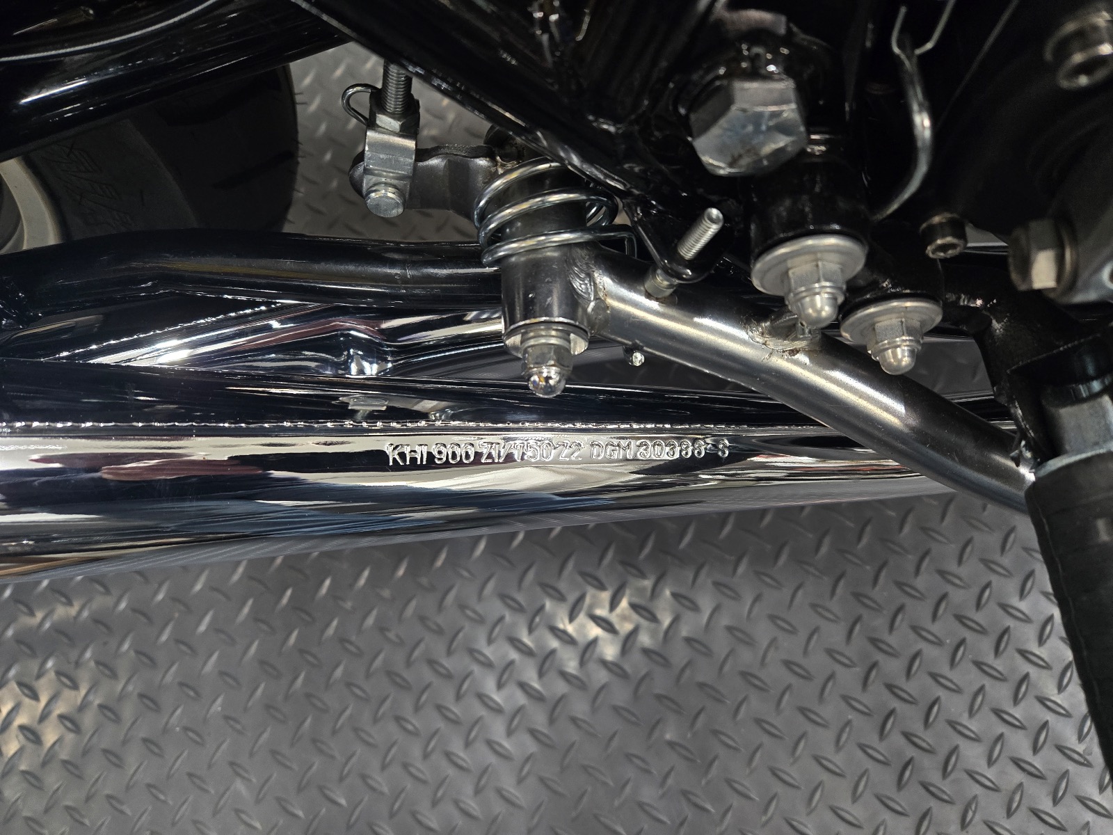

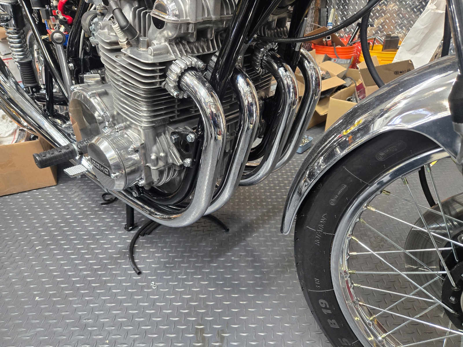

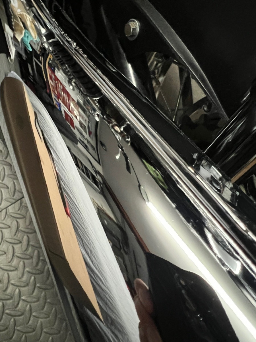

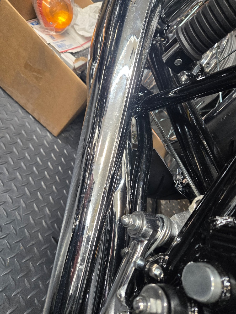

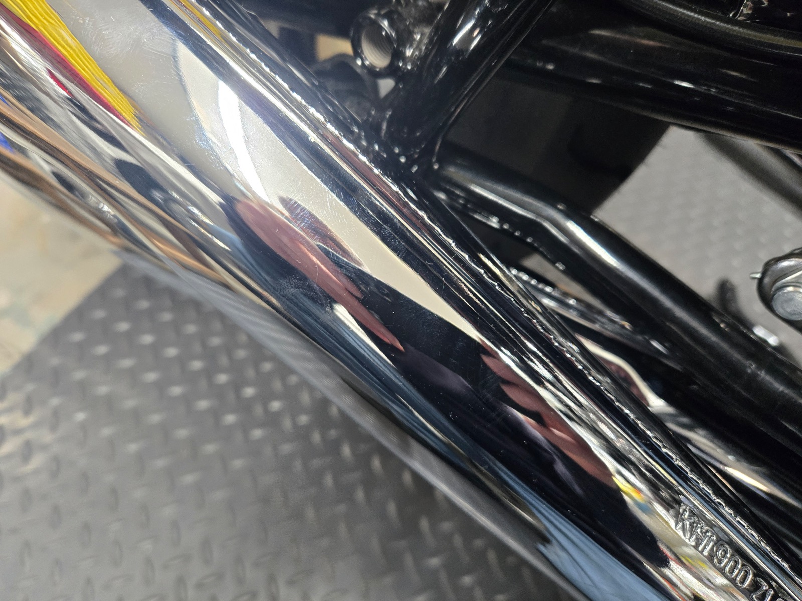

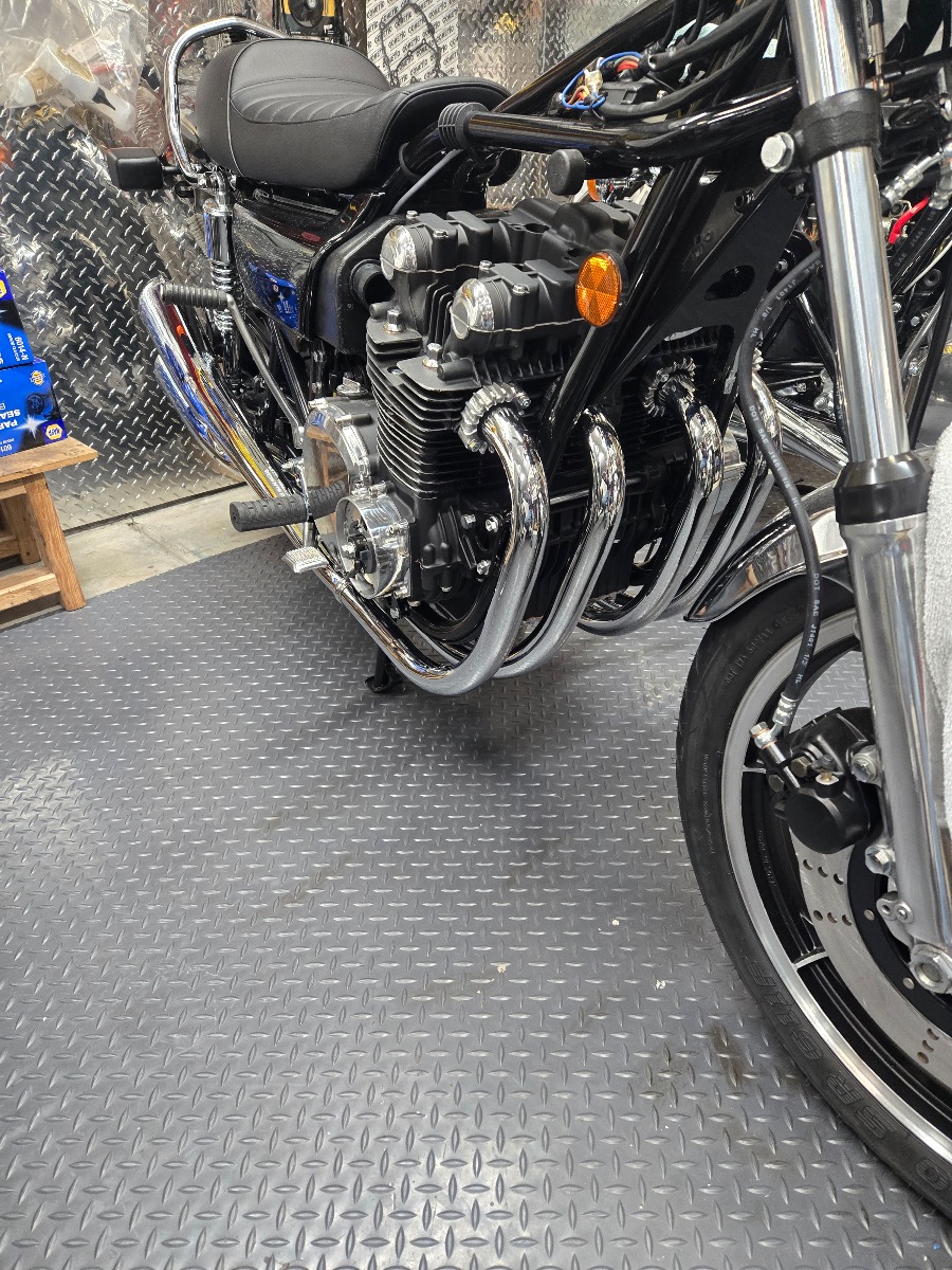

For those of you contemplating new 4 into 4 pipes for the Z1 and Kz models here are a few comments on each. I have installed 10-12 sets most of which were Doremi, PMC and way back a new MRC 4 into 4 pipes. How ever we now have Delkivic offering their 4 into 4 pipes. A while back I was looking at exhaust systems for a project of mine and really wanted a Kerker but they are impossible to find in good condition at a reasonable price. So I came across Delkivic on ebay selling their system for $1099 which they are still offering on ebay with $120 shipping. Mine came without shipping so I could not pass it up. So I finally got to mount them last night. Here are my observations. Both systems mounted fine. The Delkivic alignment was slightly better at the rear connection between the upper and lower. For some reason on the last set of Doremi the left side was slightly out of alignment making a bit more difficult but not impossible. Delkivic supplies a bolt, washers, nuts for the rear mount but the bolt was way to short so a trip to the hardware store solved that issue. The rubber piece and clamp that joined the upper and lower pipes was designed better on the Delkivic pipes which should provide a better seal.
Build quality is good on both brands but the only complaint was on the weld finish on the Delkivic. The seam that welds the two half together is not ground down or smoothed in any way compared to the Doremi as you will see in the photos. Also the Delkivic has the stamping as you would see on the later factory pipes. All in all the Delkivic is a good product for the money if you can get them for the $1099 price. The weld bothers me a bit but I will get over it.
Photos of the Doremi pipes, notice the seam weld.
And Delkivic , notice the seam weld and stamping

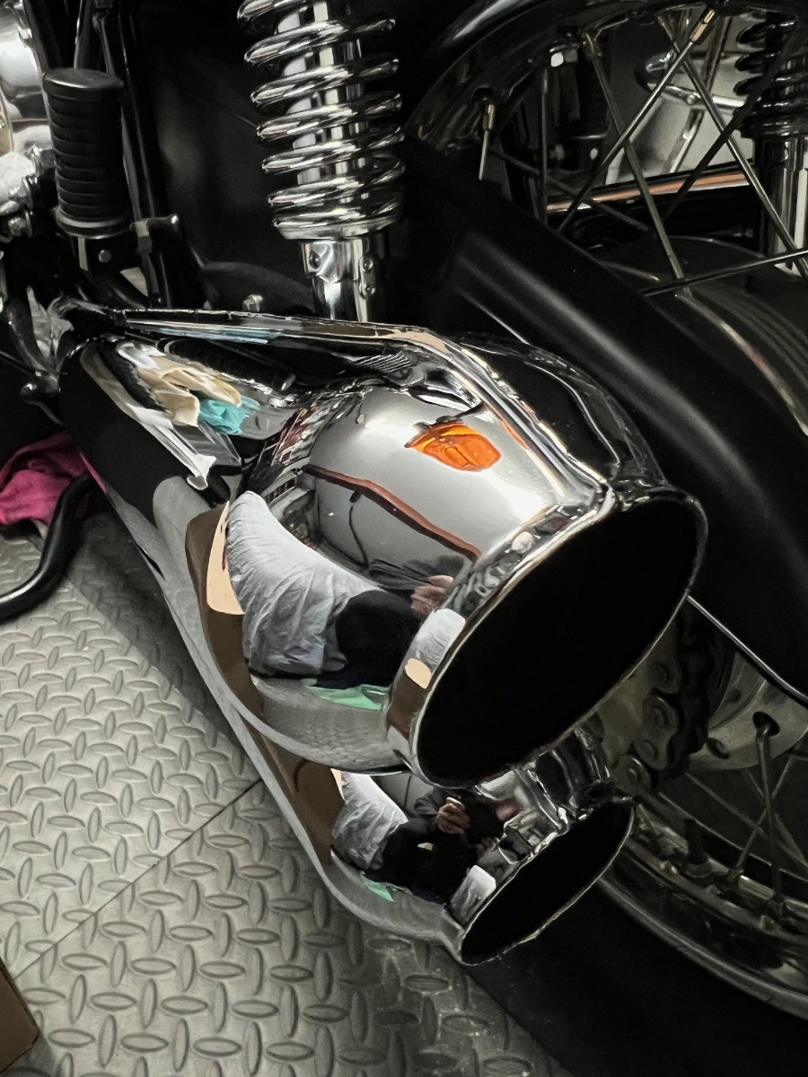

Agree with you, welds cosmetic can be improved.
Very nice bike....piece of art !
Any idea of this model? I'm happy to see these pipes like on a brand new bike but not as loud !

Both of shown 4-4 systems looks pretty well, same as the bikes, congrats!
..But how we all will remember. The original 4-4`s from `72 to `76 have all the same "imperfections" at the weldings,..NOT so clean and straight as from the Doremi...
Versus that, the Doremi looks like a masterpiece made by laser-welder-robots , ore like that...
Anyway, great pipes !!!
