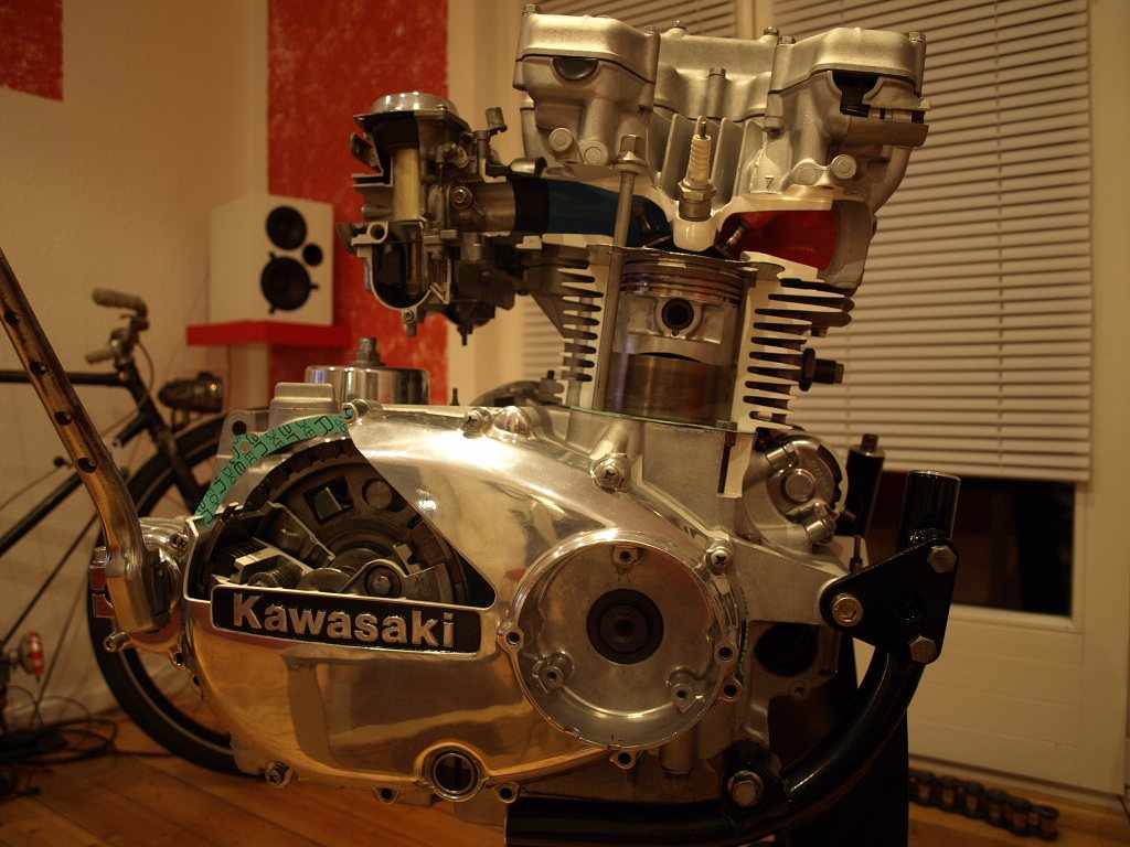

Longer vaccum carb slider, restricted rubber carb boot ports, restricted
exhaust header (welded washer) and low lift cam shafts will do reducing gas flow and hp.
www.z750twin.de/schnittmotor.htm
