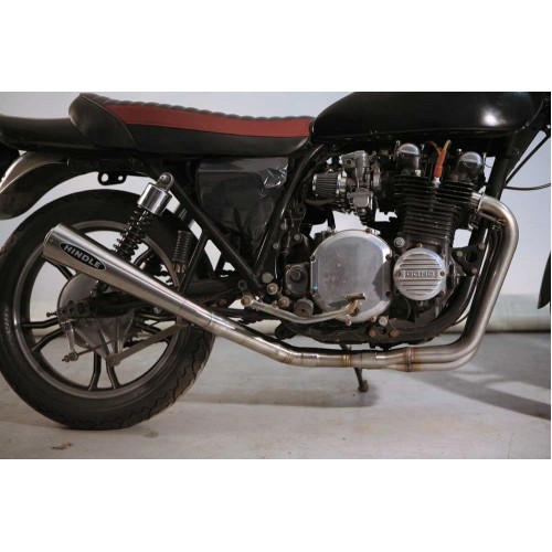

Is the Hindle really effectively a 4-2-1? The pictures I can find are not super clear, but I looks like there is a very short "2-1" section, maybe just 2" long? I'm skeptical that this would offer substantially different performance than a 4-1 with similar tube diameter and length.
The exhaust tuning parameters are specific to each engine, but looking at the 4-2-1 headers for the Honda B18 engine, the 4-2 and the 2-1 sections are roughly the same length.
I'm sure the Handle are nice, but it's hard to believe the performance would be substantially different.

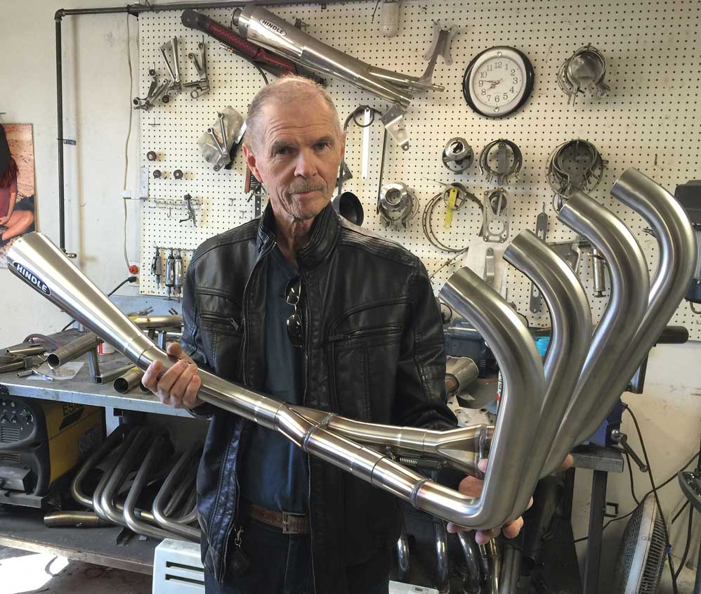

29 Nov 2024 10:47 - 29 Nov 2024 10:59Yes it is a true 4 - 2 - 1 and the sections are much longer than 2 inch.
The OP wants a 4 into 2 into 1 system..

03 Dec 2024 08:08 - 03 Dec 2024 08:10Check out that prototype muffler on the back peg wall, very short sections right into the can. I guess it hurt HP, he does have a in house chassis dyno for tuning pipe lengths. A top notch designer and fabricator!Yes it is a true 4 - 2 - 1 and the sections are much longer than 2 inch.
