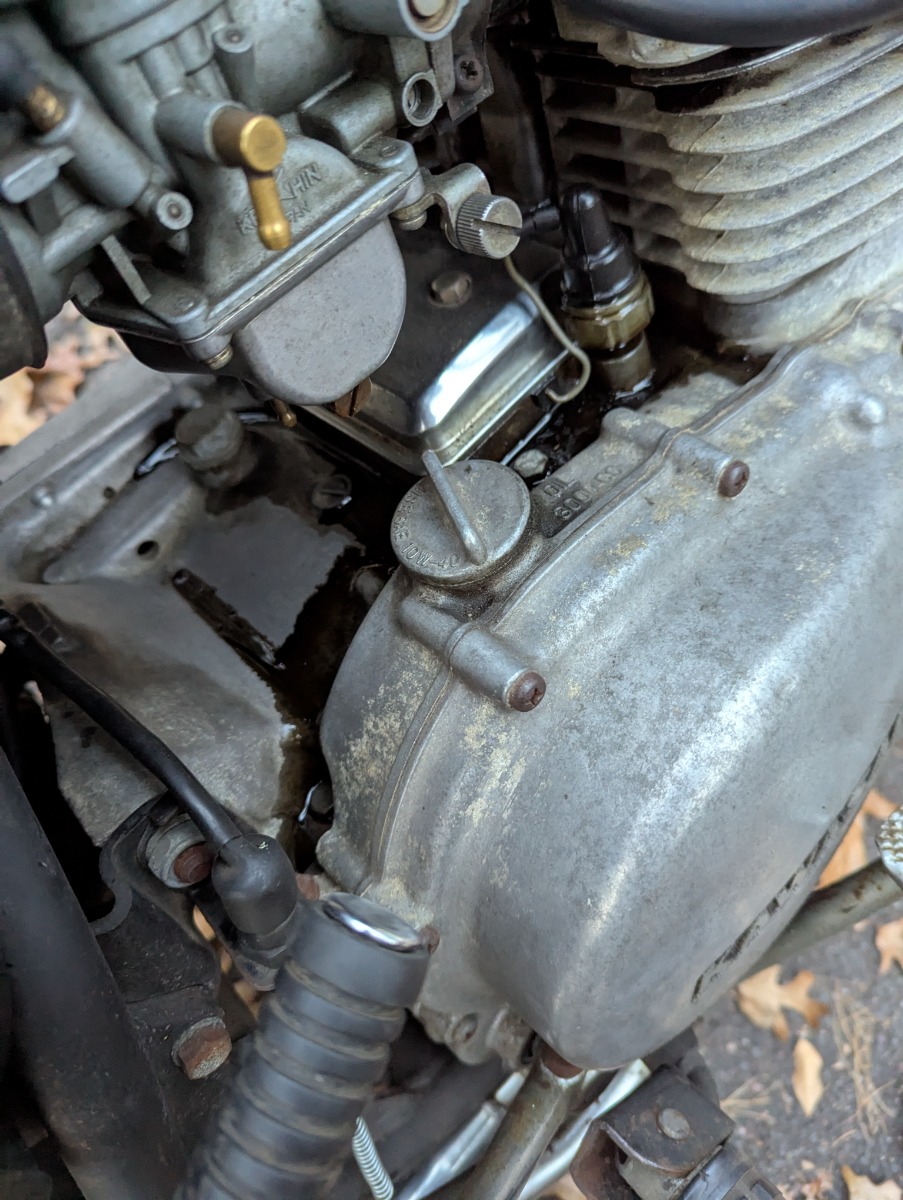

Been noticing after a ride that is see something leaking and figured it was has out of the right carb bowl so I'd started letting it run itself out of gas before I parked it for more than a few days. That was until today when after a short 20-30 min ride I see what's clearly oil in all the same spots. Any idea where to start in trying to find/fix the leak?

Clean it off with brake cleaner after noting the highest point you can see oil, then dust that area with talc and run the motor again until it starts leaking. You should be able to pin point the leak as the talc will stop the oil "running"

Either way you will need to clean it up to learn what the issue is and to keep it from getting any worse. There are several things that could be the issue. Keep in mind oil leaks, as the bike moves through the air, tend to flow backward and from high to low.

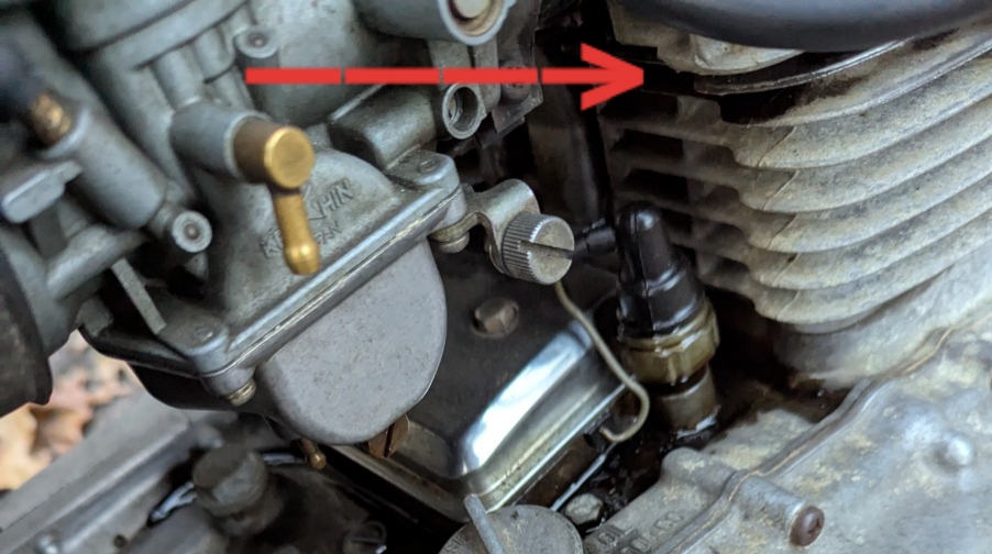

18 Nov 2024 07:36Take a good look in and around where the red arrow is pointing.
Some dampness appears to show just below the cylinder head...need to rule out that area as a possible leakage source.

Yes, I didn't see that earlier but it surely could be from the head gasket area.

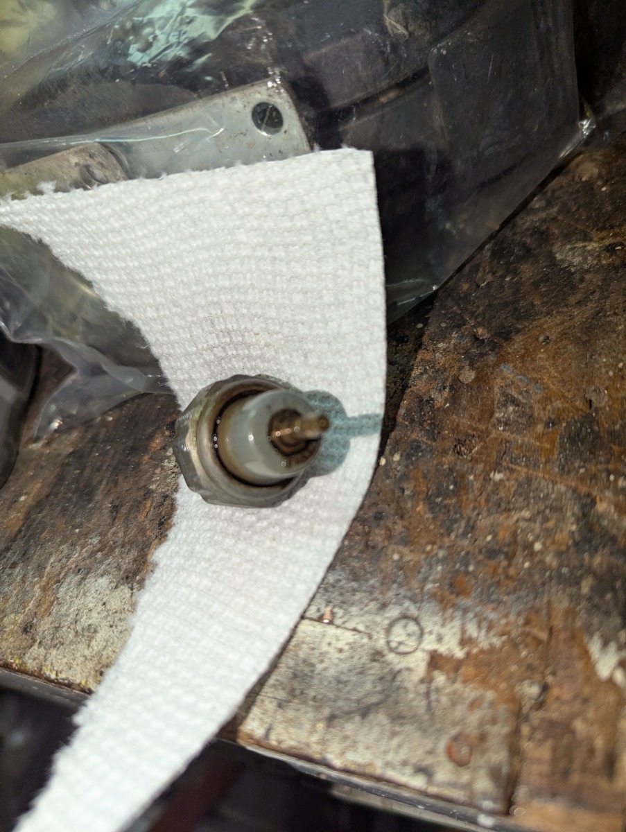

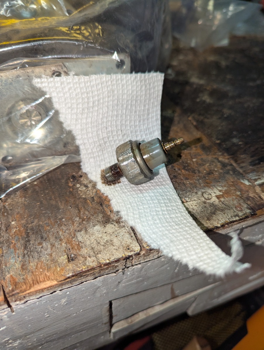

Finally getting back to this and managed to get the old one off but was hoping I'd just see a crack in it or something. Given there isn't one I'm guessing I'll have to replace it and go a similar route but is there no issue running it like you have pictured without a rubber cap on top like the stock one? Also yours seems to have another line that sits below it, is that standard ? And will the same sensor work for me if I'm screwing it right into the engine?

On mine the leak was right where the metal housing wraps around the base of plastic electrical switch part.
no you don’t need the rubber boot covering the wire terminal. I’ve ran mine like this for about 2 years now, every day, rain or shine. No problem
the line underneath mine is an oil pipe up to the rocker box. Mine is a kz440, it’s over 90% identical to the kz400 but that must one of the few differences if you don’t have that oil pipe.
you can certainly screw it straght in to the engine if you don’t have the oil pipe there. And if you don’t have a new pressure switch right away you can plug the hole, I used a 1/8” ntp threaded plug which is just a tiny bit too big but the thread pitch is almost identical to the metric thread that should be. I had a die the right size and used it to basically clean up the threads and it threaded right in and sealed it up until my new pressure switch arrived. I believe it was 10mm but I am not certain now. I do know that it was an uncommon thread pitch (no bolts available in that pitch at the hardware store). But I did have a die the right pitch and found that an ntp pipe plug is such a close fit it just needs a cleanup with the metric die.
