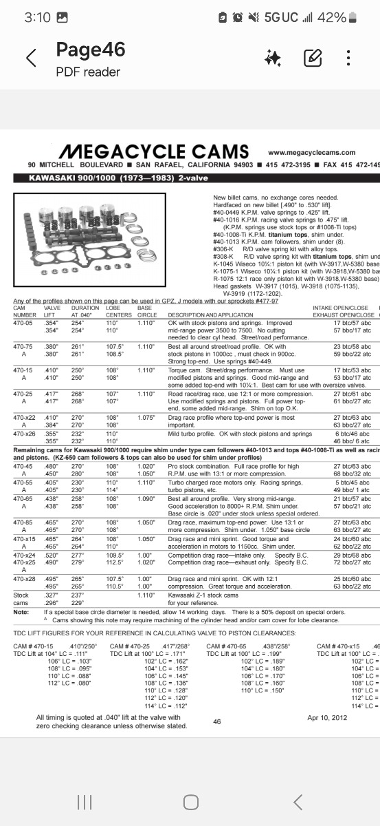

Could yall educated me on this cam :
470-x22a cam by megacycles?
I am currently running a set of megacycles 470 x 15a torque cams and I'm looking for more top end.
I'm going back to boneville this year for world of speed and we want more speed!!!
Current motor build is weisco 1105 pistons, 470-15a cams, vm29 smoothbore carbs, street port with stock valves. Murray x pipe, electric ignition - Ran 129.59 mph this year and we want more of course 😀
looking into big valves and more duration out of our cam.
does anyone have any experience with these cams or some suggestions?

Like Zed said that seems a bit slow for 1100cc and he is correct with keeping the cams as is and finding out if its optimally tuned. If you can get some 31/37 valves in it and open up the ports more then you will probably see more gains from the head than a cam swap would give.
As far as that cam swap, if you can't increase the compression you will probably loose HP with the longer duration cams. You need to be running with as much cylinder pressure as possible regardless. If your under 170 PSI you may want to look at skimming the head and making sure the pistons are as high in the barrel as possible (zero deck) Most won't go racing with less than 200 PSI.

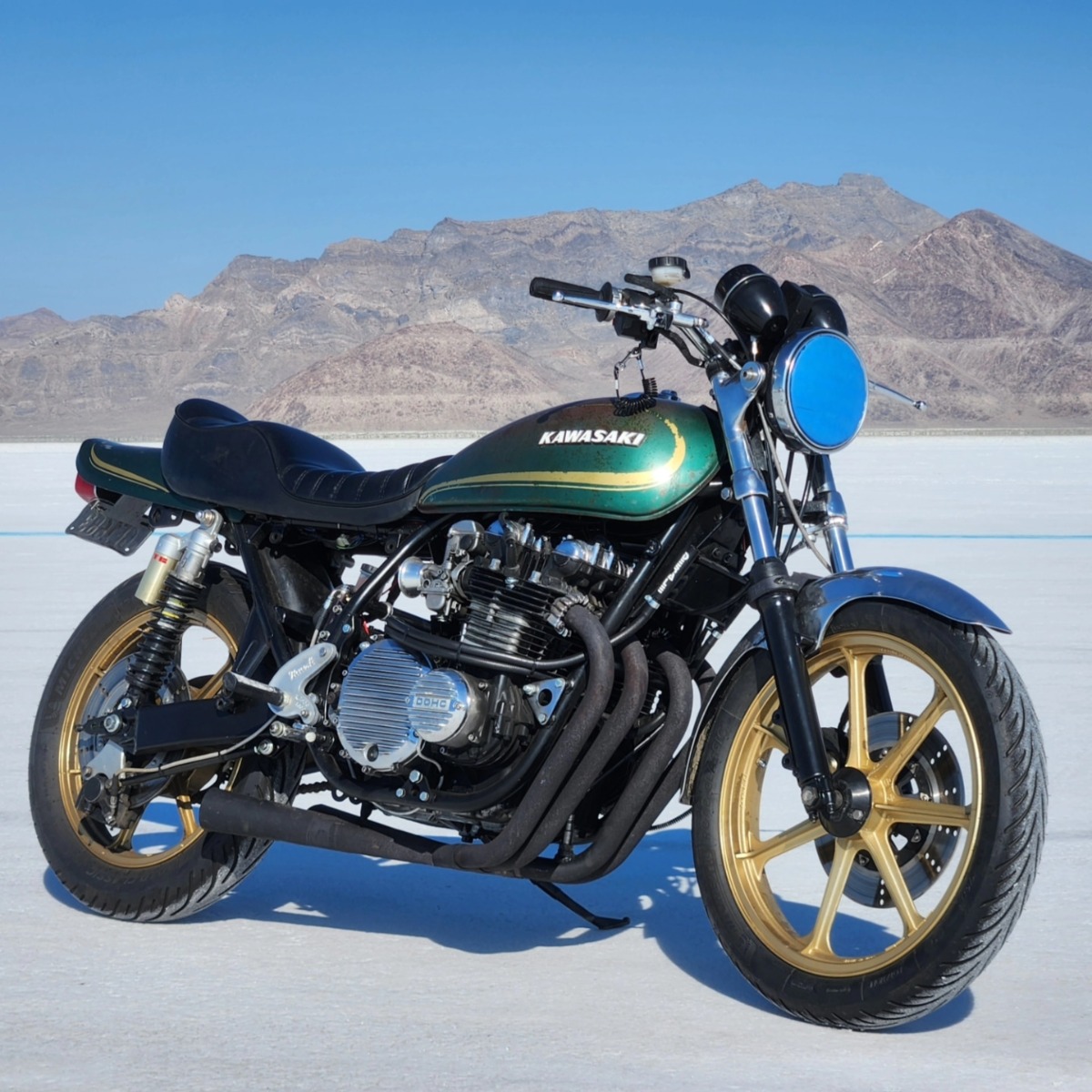

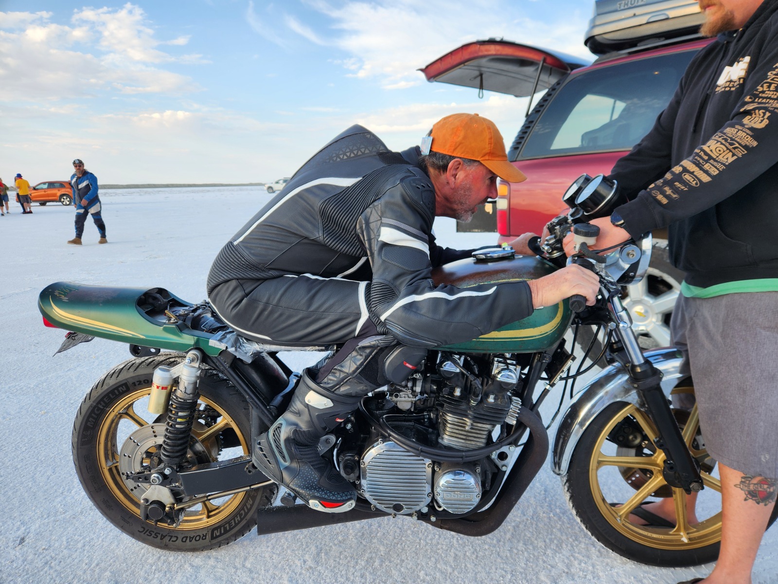

I know its a street bike (license plate) but the back seems jacked up a bit, are you a big guy? Just saying rider size has something to do with MPH. Lowering the bike and cutting weigh will help as well, just read the book "One Good Run" actually a lot of good info buried in it.

I am a bit bigger at 6'1 240lbs.
I have a suzuki gs1100 swing arm and 13" shocks to go with it. I love the height for when I'm commuting (i was riding this 20 miles each way for a while this summer to work - it was a blast!) or just out riding about. But we will need to get lower this next year. As we chase speed it does seem to come with some style and preference sacrifices ...I have been looking at heads, seems with the passing of Jay - ape is no longer offering all the head services. I have been keeping an eye on the marketplace.
The community arround the salt is great we had lots of advice given and one that caught me by suprise was how many people said don't stress over weight, it's the correlation to acceleration that makes weight savings important, but once you have momentum... It appeared less important to those guys idk 🤷♂️

Nice machine, perhaps a small bullet fairing could cut more air.

Yeah, I was thinking you were on the larger side.
I am 5'6" 170 lbs, use to be 130 lbs 40 years ago! Power to weigh ratio just means your engine won't be as stressed.
I was just thinking about getting out of the wind, the lower it is the less air you catch. I come from drag racing so its the same just geared different and way more distance to run. Since your doing a dual duty machine then there will always be a compromise.

This last year, I built the bike and my dad was our rider. Checking off those dream boxes. He weights 80lbs less 😀 after some advice from the lowbrow and old bike barn guys we did pull the seat and duct taped the frame rails to create a cradle for him to get down more and flipped our handle bars. Some quick pics 📸
