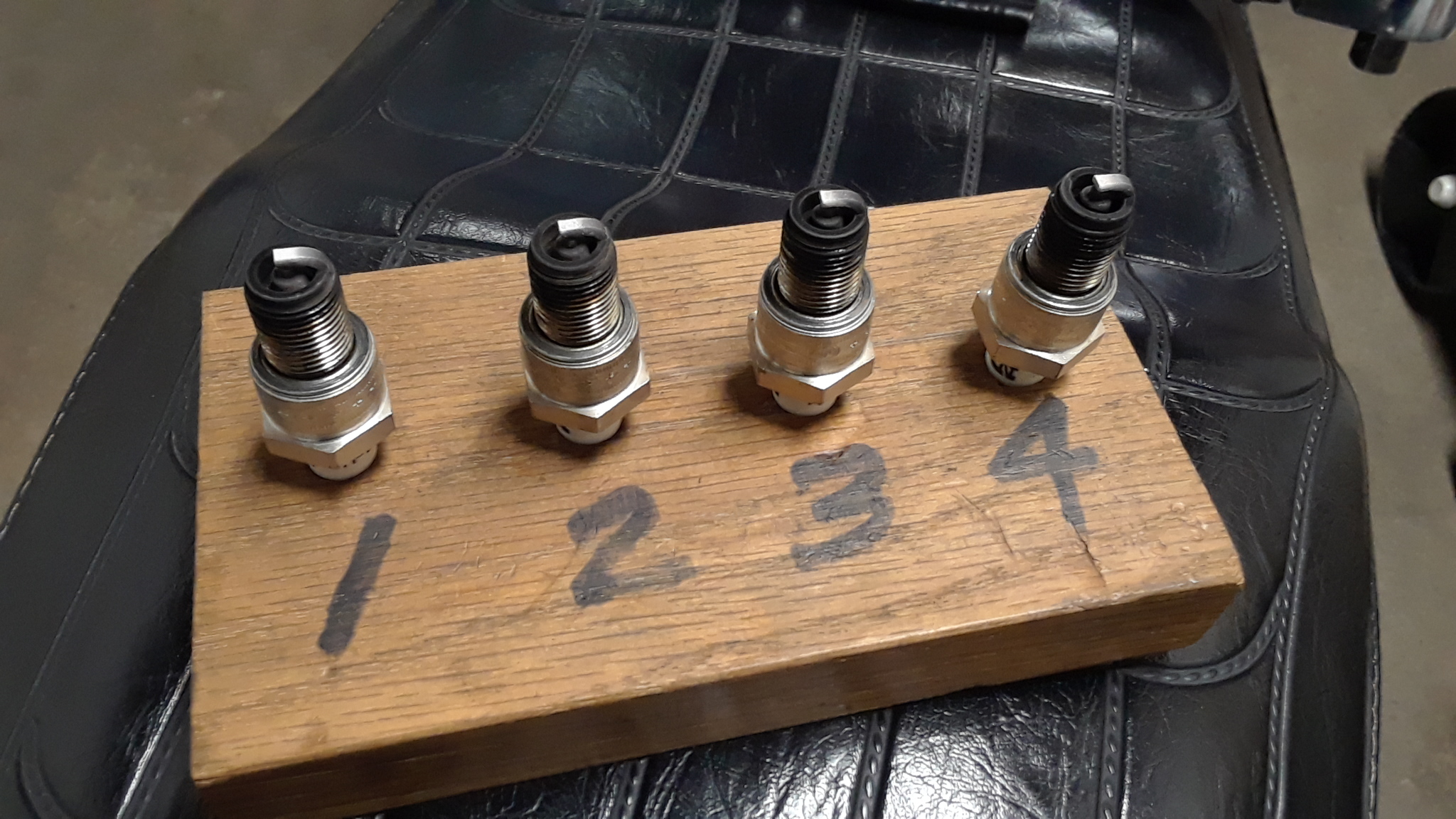

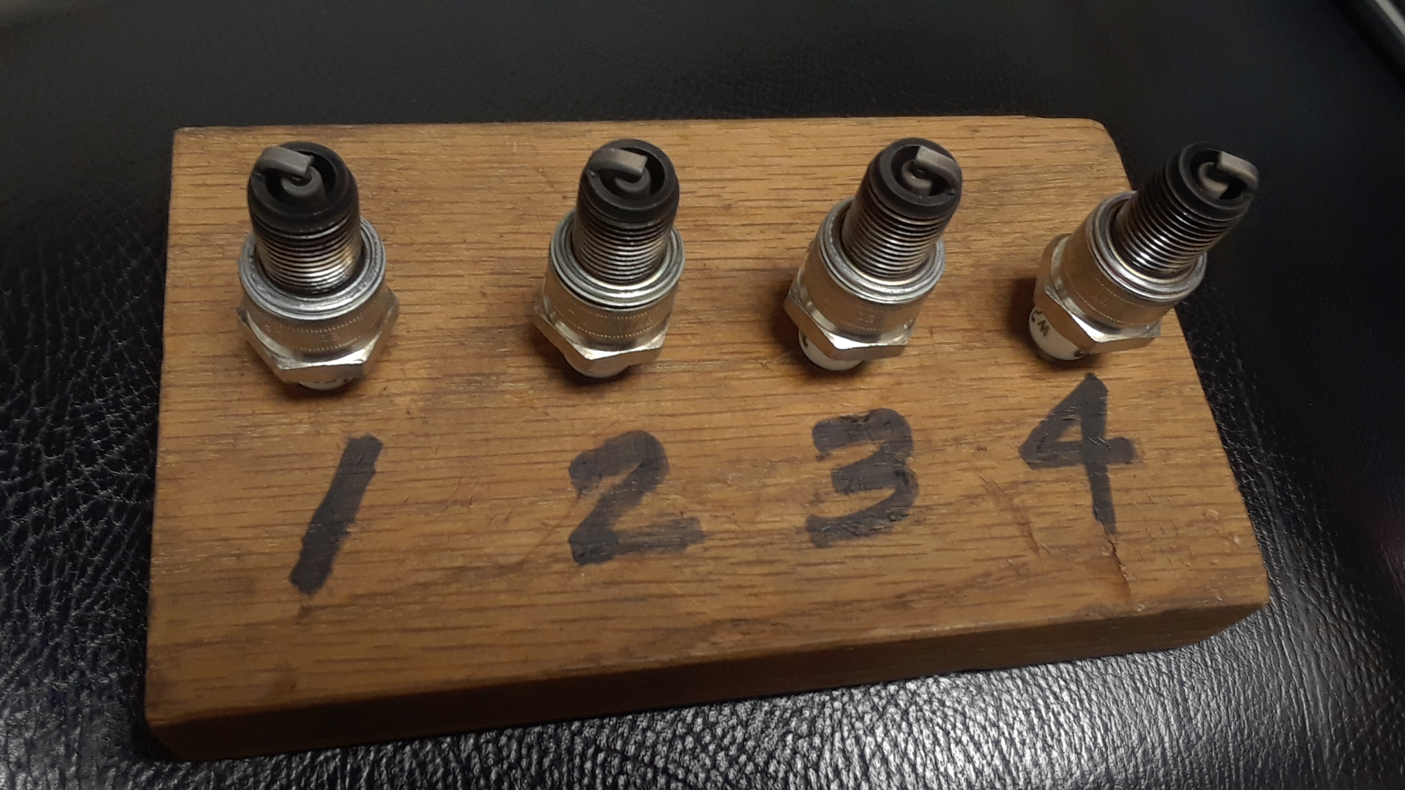

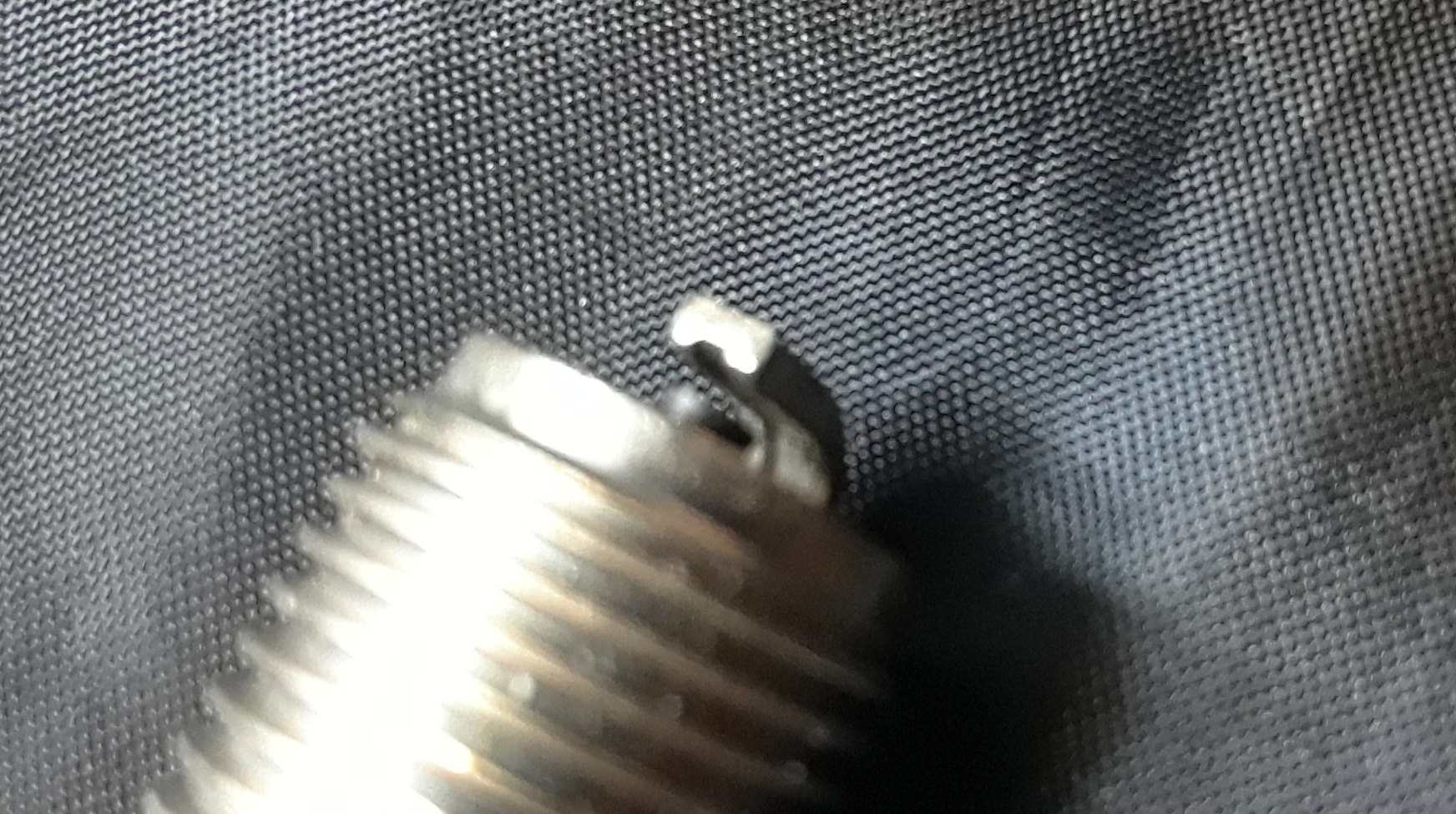

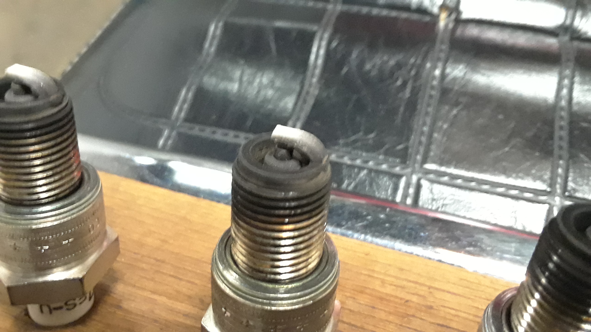

U-Groove strap feature:
A member suggested that one step cooler plug would provide improved combustion for my engine setup.
The W27ES-U straps have a well defined burn area compared with the W24ES-U shown below:
