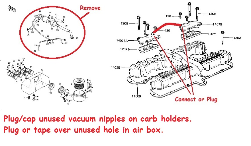

So I continue work on my '81 KZ750H. When I got the bike the carbs, air suction system, and starter coils were off the bike. I have since rebuilt the carbs. Can I trash (leave off) the air suction system as long as I have a hose connecting the reed valves and I put barb plugs on the carbs where needed?

Connecting the two air ports is one way. Installing block off plates, such as APE, is another.
And yes, block off all unused vacuum ports on the carbs.

Some where on site there is this posted by Patton but I am too lazy to search for it so have attached it here.

07 Nov 2024 10:51I likely will be ordering the A.P.E. plugs as I like the idea of a clean look.
