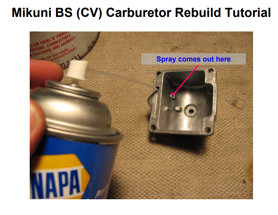

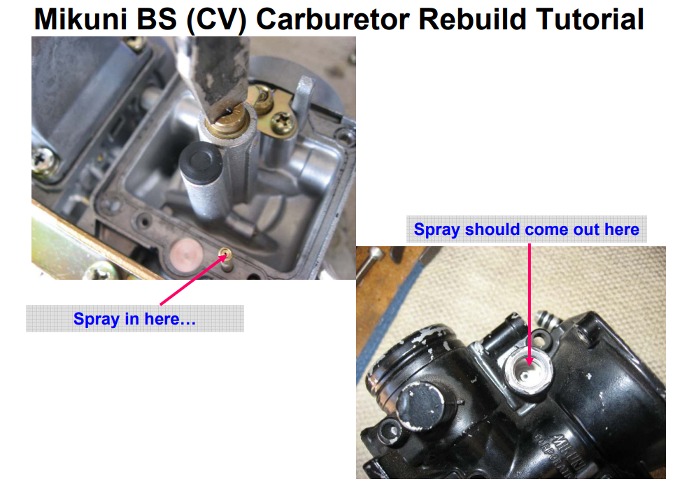

If it doesn't run when cold, but does when hot, that suggests that the choke passages in the carb and float bowl may be plugged.
BTW, the photos are for CV carbs, but the idea is the same. When spraying to check the carb body passage, put the small straw from the carb spray in the small hole in the bottom of the choke plunger passage.

Many thanks the choke is just an enricher but I like the idea of this being at fault all the same 👍I guess it’ll mean pulling the carbs out again as not really possible to work on them in situ.
The rubbers are not to bad to work with but as we all know the airbox just doesn’t go back far enough lol. Might have a look when the tanks running low on fuel.

Was hoping to report back saying the enricher tube was blocked but it wasn't lol. Everything checked out OK....I started her and all 4 warmed up which either means there was a partial blockage which I cleared out whilst testing or it was a lucky start? time will tell.
