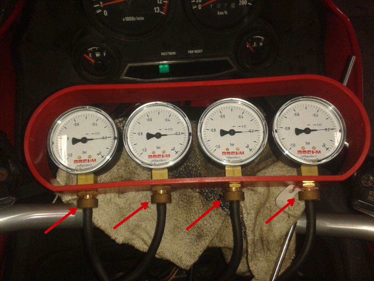

I did the carb sync today. They all read right around 10. Seem low,? How can you tell which which carb is wacky with the carb sync guages? The only way the rev comes while riding is to upshift. Slowing down whilst do it to.. I am gonna get new intake boots, give that a go.

16 Nov 2024 13:29 - 16 Nov 2024 13:30The wacky one or ones will have a different reading. This is assuming the gauges have been calibrated to each other.I did the carb sync today. They all read right around 10. Seem low,? How can you tell which which carb is wacky with the carb sync guages? The only way the rev comes while riding is to upshift. Slowing down whilst do it to.. I am gonna get new intake boots, give that a go.
Most folks I know say the actual reading is not as important as having them all as close to the same reading as possible.
