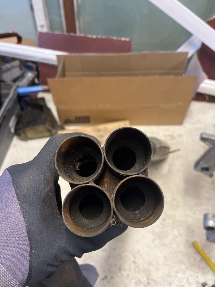

Found a Moriwaki exhaust on Croooober for my 500 racebike.
When I look into the collector it looks like 4 conical restrictors.
This is not a racing exhaust so maybe it’s for damping noise? Or can it be something to increase performance?

I would guess it's to boost low end torque ??

I guess it needs to be perfectly tuned to the engine then.
I should run it on dyno and then remove it to compare 🙂

It seems like a weird place to put an exhaust restriction. Most of the systems I've seen have the restriction at the front of the baffle in the muffler.

08 Oct 2024 00:08Yamaha also put the "EXUP" valve in the collector ?It seems like a weird place to put an exhaust restriction. Most of the systems I've seen have the restriction at the front of the baffle in the muffler.

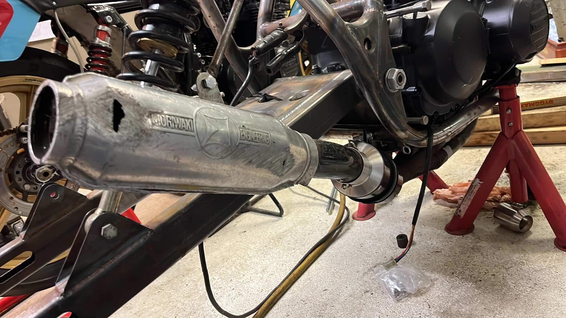

The monaca muffler looks cool but i can’t recommend it.
I had to cut it open to repack it.
It had to be repaired anyway and now it’s modified so i can just pull the aluminum part off from the perforated pipe and change/fill the wool.
