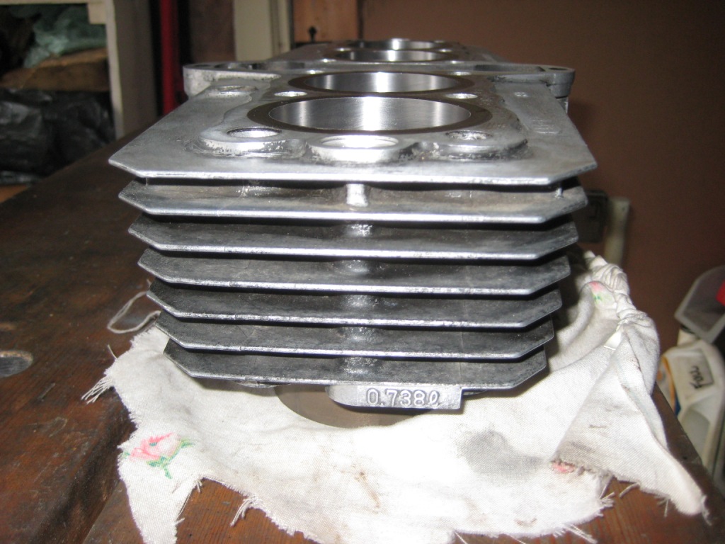

questions: my uncle *thinks* someone before him swapped the jugs to make it a 750. I don't know what I'm looking for, to confirm. I have no idea if the valves have ever been checked. Using an amazon borescope, I didnt see anything alarming in the cylinders.

The capacity 700/750 should be marked on the back of the cylinders (unless the stock has been over-bored to 750)

On a 750 the capacity is on the LH side (#1 cylinder)

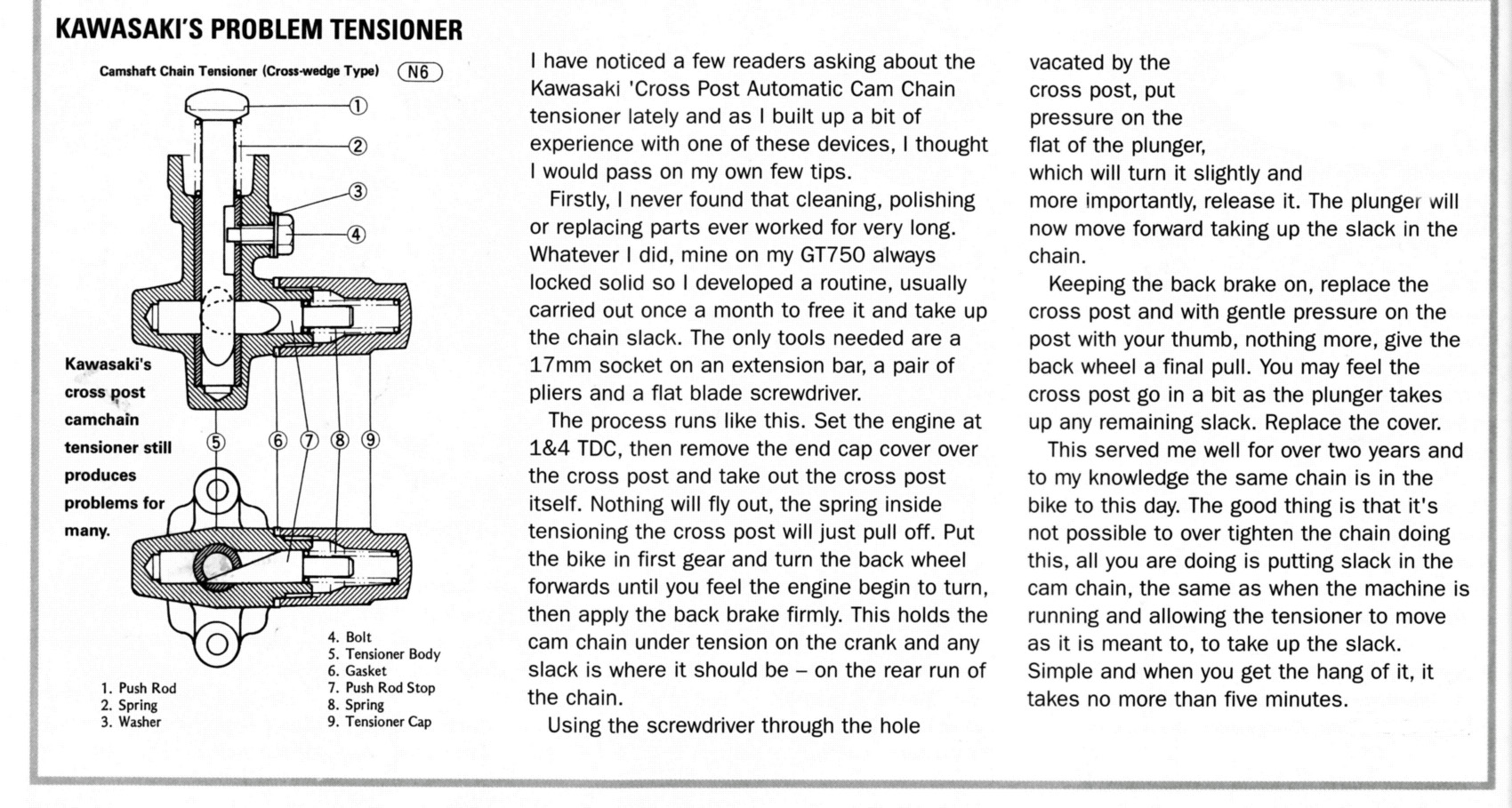

In case you didn't know, after your top end work, before you put the valve cover back on, you must release the cam chain tensioner. Put the engine at 1-4 TDC, and pull the cap off the cam chain tensioner, releasing the spring tension. This will loosen the tensioner, and allow you to put the valve cover back on. Once done, put the tensioner cap back on.

Nessim.
Thank you for the insight about the chain tensioner.
I have the FSM printed out and in a binder. I've read over the procedure for checking the valve clearance a couple of times. I understand the process and what I'm looking for. My biggest fear is that I will damage something in the process. Such as breaking a bolt off when removing the valve cover. Or, not getting the timing marks lined up perfect and bending a valve or damaging a piston. As far as what to have on hand when i do this, it should really only be the valve cover gaskets and whichever shims are needed, right? Should the half circle rubber plugs also be replaced every time the valve cover is removed?
As far as the tensioner, should the tensioner be completely removed? I don't know what you are referring to by "the cap" to remove tension.

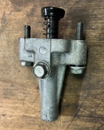

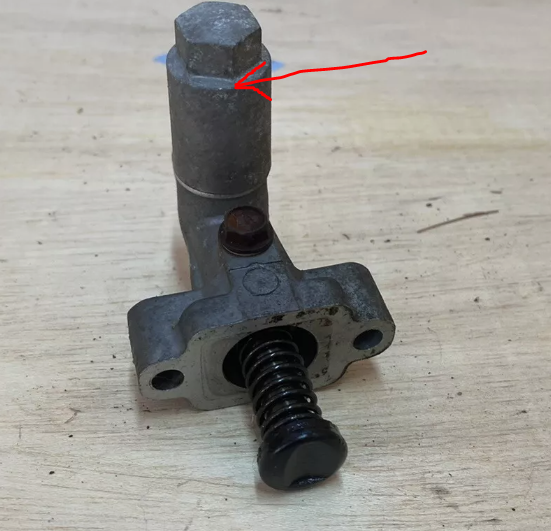

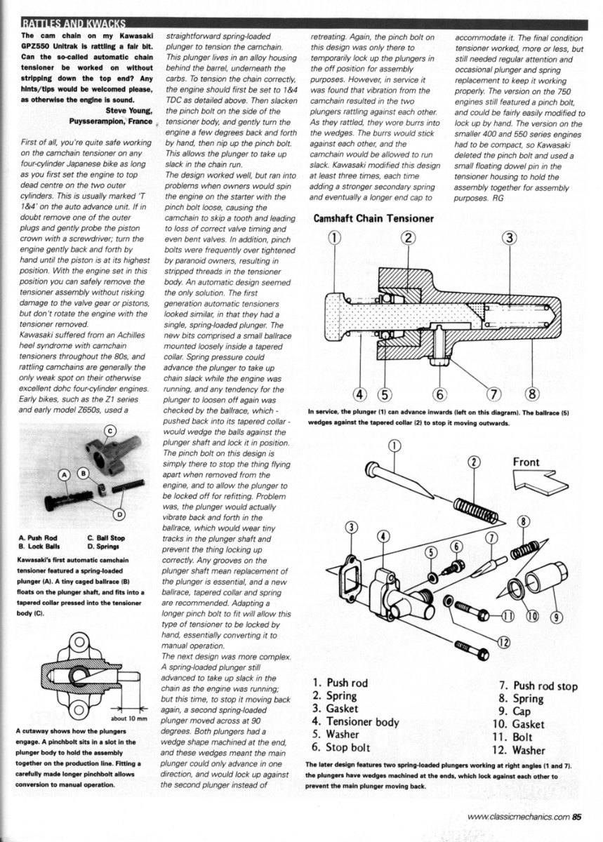

Not sure if this will be of any help or not, but here are some docs I have on the tensioner
for the 650/700/750s
