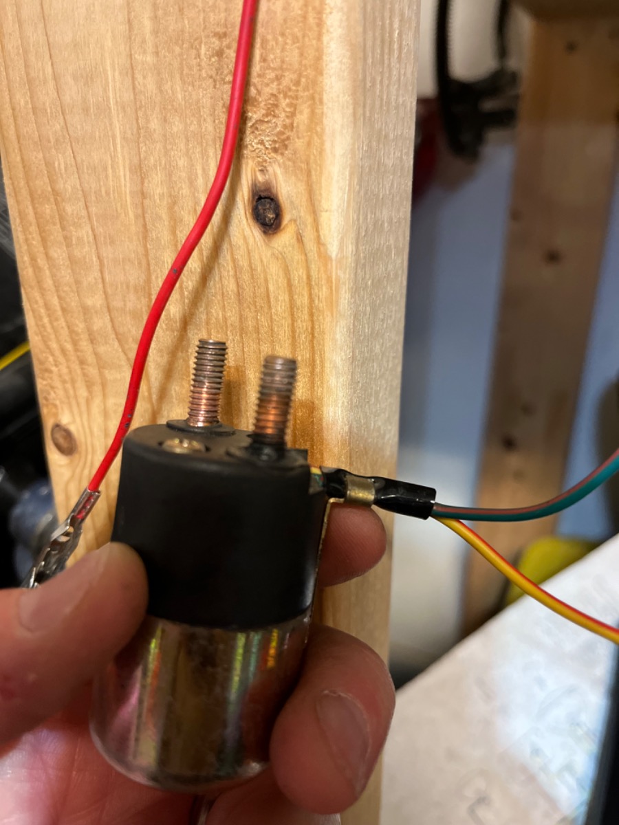

At least it does not seem like there is catastrophic failure, yet. I did a quick electrical test and have intermittent test light to the power side of the solenoid. Nothing from the output side. I will dig through the wiring and see if anything is loose, and use Wookie58's guide to troubleshoot.

Solenoid is good, sort of, and I was able to get the bike to crank.
The positive lead was not making good contact and I noticed what looks like melted plastic. Looks like a solenoid will be on the shopping list to be safe.

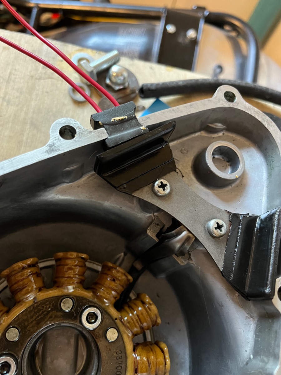

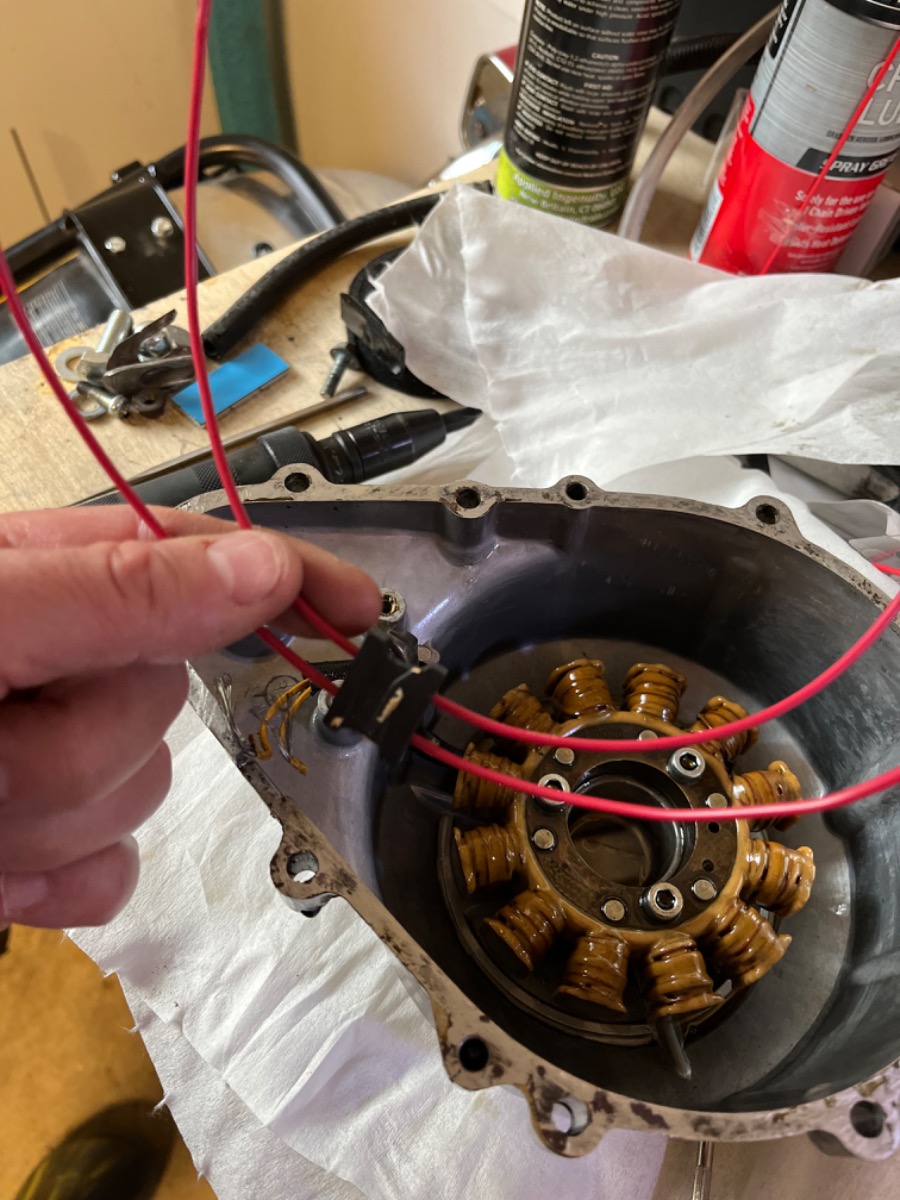

I guess the next step is drop the oil, order some gaskets, and see if I can extend the stator leads out of the case.

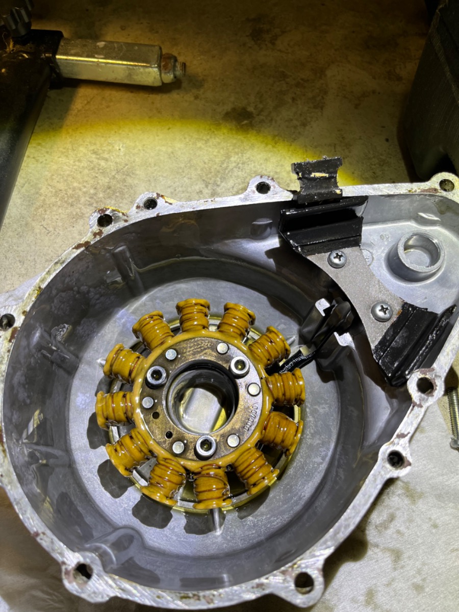

Got her working again. So far no oil leaks from the left side case, and I confirmed the stator is working as the battery voltage increases with some revs.
