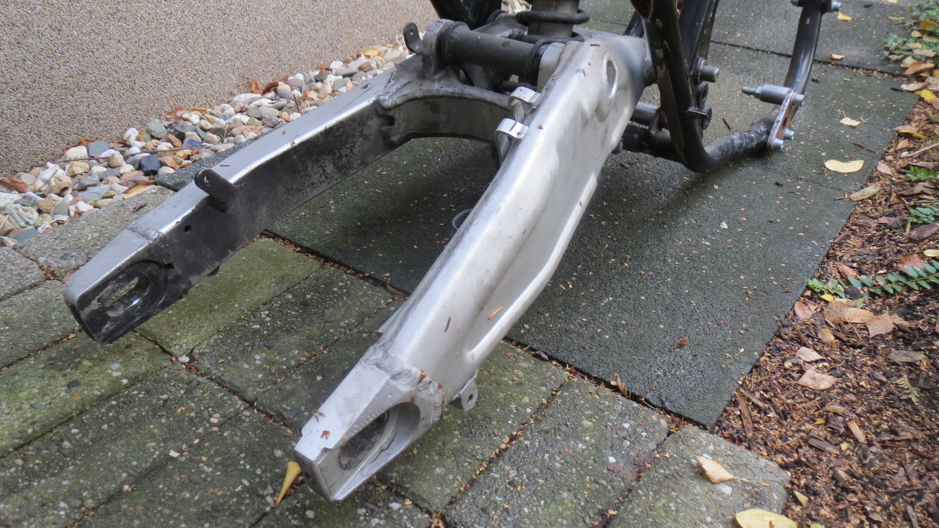

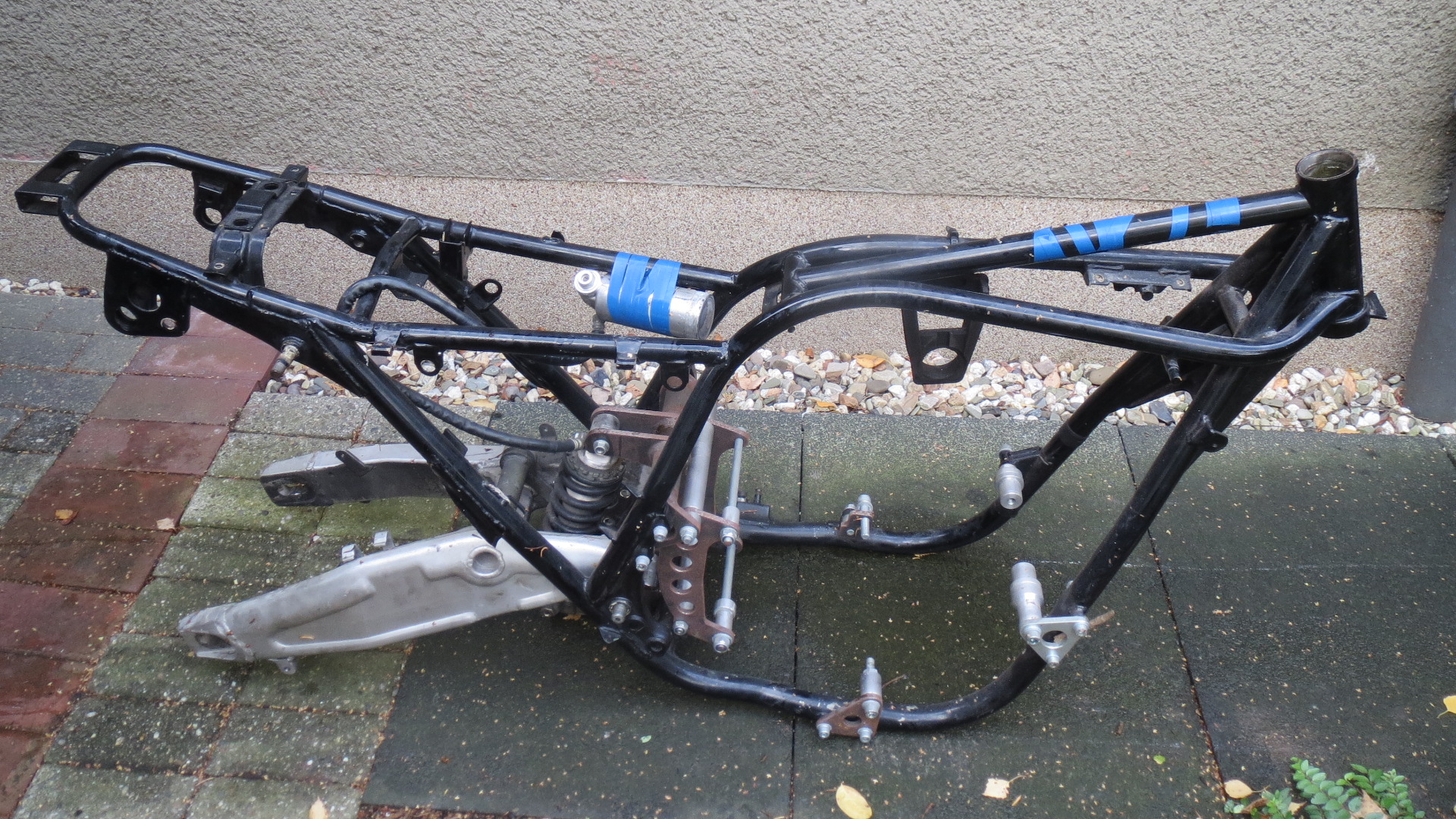

Re: Engine swap?
24 Aug 2024 05:03
- Vinsky
- Posts: 122
- Thanks: 131
Re: Engine swap?
24 Aug 2024 14:32 - 24 Aug 2024 14:47Very impressive fabrication. Welds especially.
