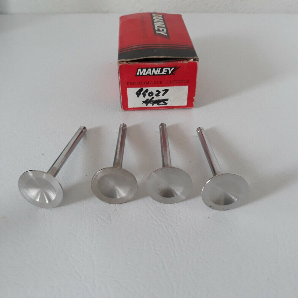

I am not sure if Del West do replacement sizes for Kawasaki but I know Manley does. I used Manley SS replacement valves on my '74 Z1 head, at 32mm they are meant for a later head, I cut them down to 31mm to fit my valve seats.
My intake valves were supplied by the guy who did my valve/port work, I think they were KW SS 37mm. Manley has been providing Kawasaki listing since before 1985.
There are lots of used 7mm Del West valves on Ebay that could be cut down and used for Kawasaki heads. Seem to be pretty cheap as well, used stock car parts
