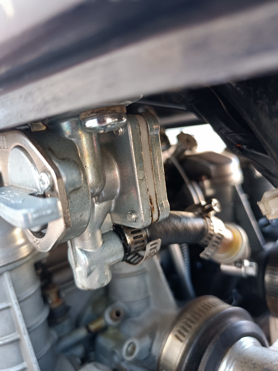

Hey y'all, so I just went to start her as usual and noticed the petcock started spurting once the gas was flowing. I was wondering if it's just a matter of tightening some bolts or if there's another process to fixing it. The dark mark in the photo is where the gas spurts from. Thanks ~

You can try snuggling up the screws a bit, but be careful not to crack the white plastic part. I bet it is time to rebuild the percock. All the rubber bits eventually deteriorate. It is not a difficult job. Seems like there is a good tutorial in the Filebase or the Articles section of KZR. One often overlooked bit is to insure the seat for the oring is spotless and free of pits. A light polishing of it will help insure trouble free operation.

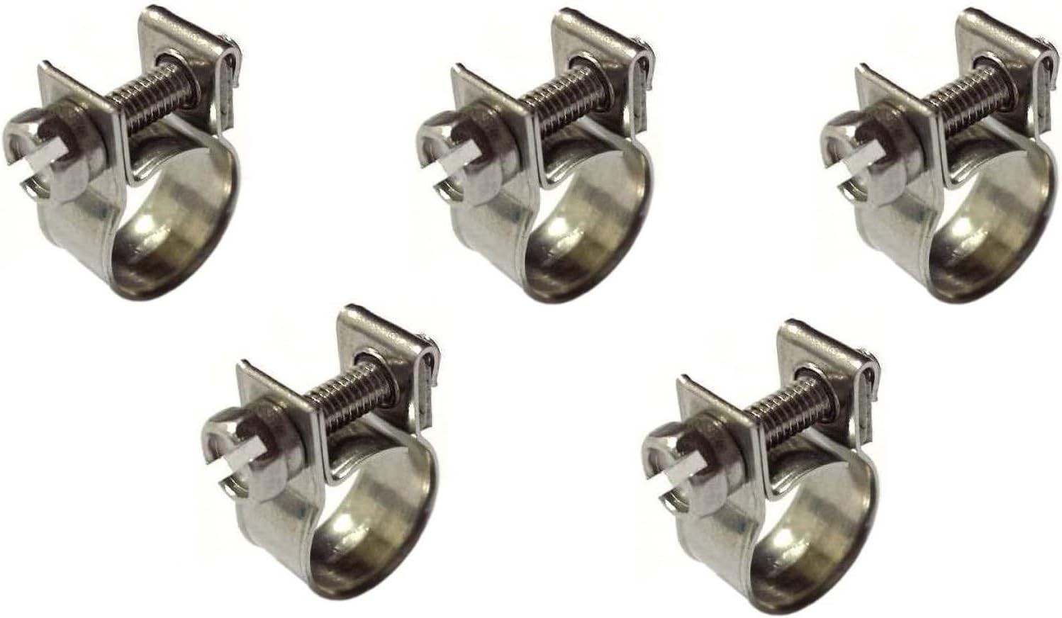

Your kind of fuel hose clamps will damage (tend to tighten too much) the fuel line sooner or later!
This kind of clamps is the better choise for that task.

As suggested, try all. But..that looks pretty clean for an original TK petcock? Is it aftermarket? If so rebuilding it would be futile. Outwardly they seem like a simple device but the castings DEMAND a certain protrusion length and diameter of o-ringed shaft off the metering side of diaphragm. So purchasing a "rebuild" kit would certainly be a gamble if it's not an original TK because of those unknown perimeters. And appears yours is indeed leaking off the metering side.

#902641
