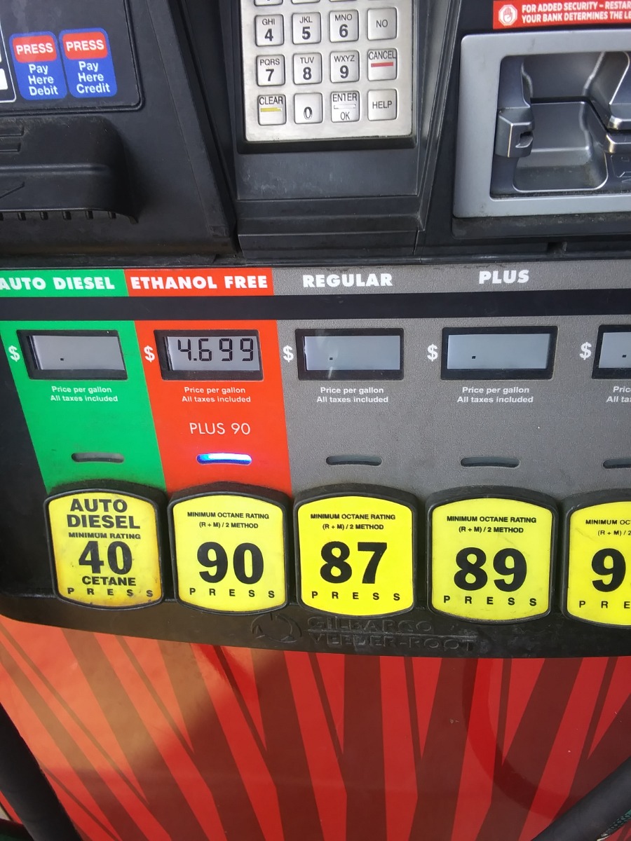

While on my Sunday morning KZ ride, I stopped in a neighboring county and noticed that the Shell station there offers their 90 octane, ethanol free “Recreational” gas. I’ve found that if I keep my bike maintained and tuned - and ride it regularly - I have pretty good luck with running whatever the high octane available gas is from my local BP station (which always includes ethanol - no other options that I’ve seen around here). But I also know there are lots of strong feelings out there about ethanol and was wondering if anyone has any experiences, good or bad, with Shells “recreational” option.

If you ride regularly, the E10 stuff is fine. Or, use a fuel stabilizer, and that's fine also. If the price isn't too high, I'd rather run E0, though.

I'm super lucky in that the Circle K down the street from my house has ethanol free fuel as an option. I've been running only that for the past three years on my Z1. I've definitely seen an improvement in the condition of the fuel lines and carb seals vs. the three years previous when I was using fuel with ethanol. Especially the fuel lines, they'd get very hard after a while with the ethanol fuel (at least the lengths of motorcycle fuel line I'd buy from the online z1 part retailers)

Ethanol has some positive qualities in fuel. It increases octane for one. But it also has negative qualities, including poorer mileage and a hotter burn. If you can access non-ethanol fuel you will be better off in the long term. I just replaced a carb on my RV generator because it was so gummed up it wouldn't allow fuel to pass through it any longer.
