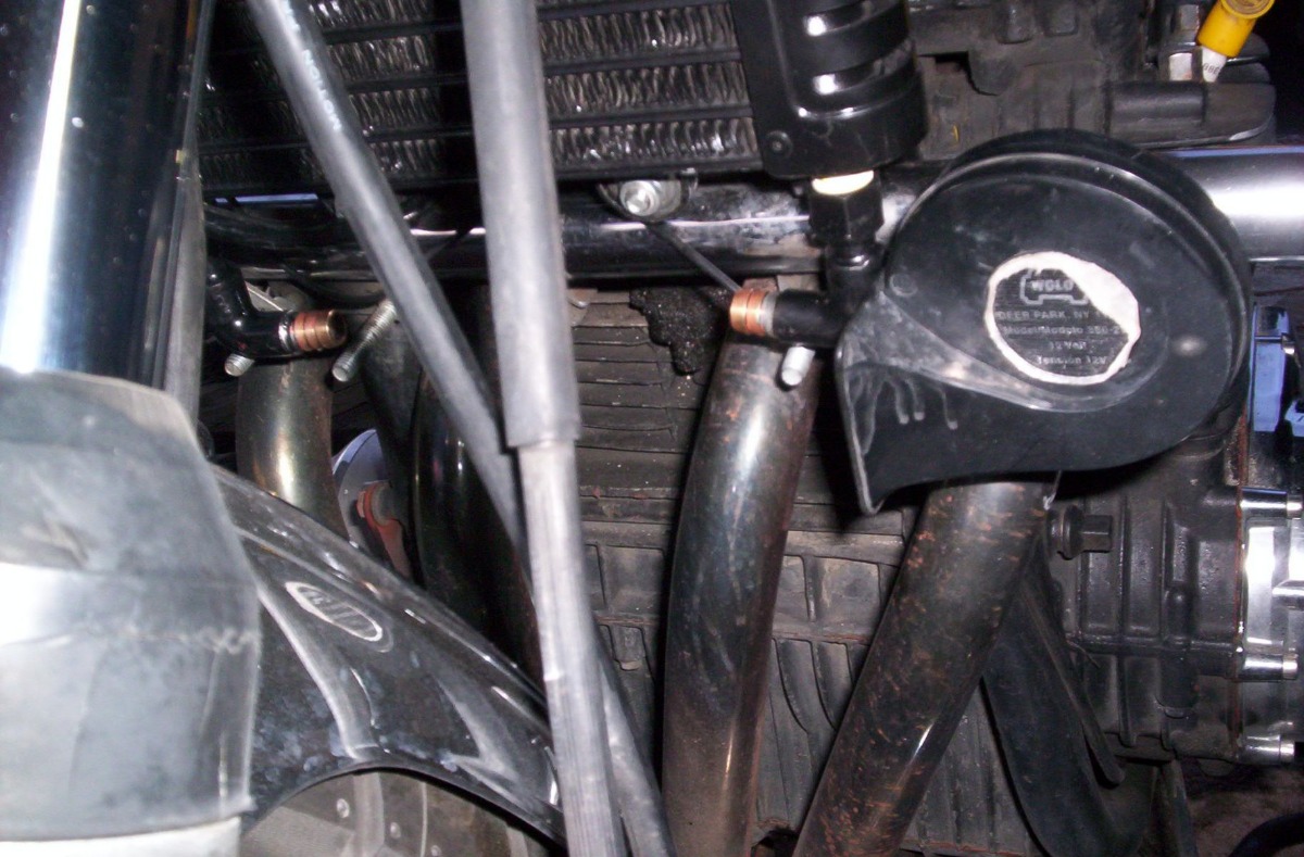

I fave a 1000J motor in my race car and having overheating problems. I took out a 9x9 fan forced air fin and tube cooler with AN-8(.4375 dia) hose to it. Was set up in a very poor position.for cooling. I have changed to a Setrab Series 6-19 row(plate type) in better air flow. But, concerned about oil flow as the GPZ fitting has 1/4NPT pipe going to it which has a .368 ID where the GPZ oil fitting has ID of .460 so .106"sq vs .166"sq . Since the motor is behind me out of the air stream with several large cooling fans not all well placed oil cooling is critical, I have been pegging my temperature gauge at 250F and easy running for a mile or so doesn't cool it down much. Using 3/8 NPt and a -10 hose(.5625 dia) would greatly decrease the pressure loss in the oil cooling side. I don't have any pictures of the new arrangement. The old arrangement had the cooler in the side pod (door ish)horizontal with a cooling fan, new arrangement the cooler is in the top of the side pod where the air duct is. Pictures attached. There is European guy on Ebay who can make an oil fitting with -8AN outlets and Web Bike has them also, but neither has the bypass Kawasaki put there for some probably good reason.

I see an air and oil cooling problem in the cooling air flow guiding enviroment.

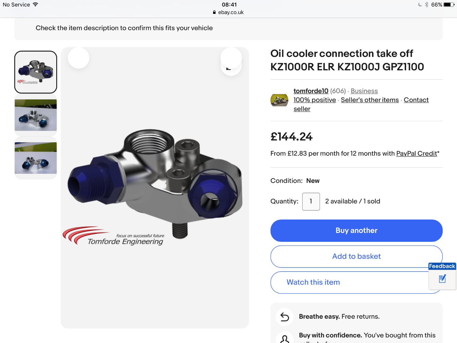

When you talk about a bypass I am assuming you are referring to the passage between the two sides of the oil switch housing ? If so this isn't a "bypass" the stock "J" doesn't have a cooler so this is the main oil gallery. If this passage is open on your set up then the cooler will be doing next to nothing which may be a large part of your problem. When fitting a cooler to a "J" this passage needs to be blanked or removed. On my build I am using the below fitting which replaces the stock oil switch housing and has no bypass passage so the full flow runs through the cooler. This fitting has 18x1.5mm fittings so you can use AN8 or even AN10 fittings

The fitting you show is the one I am looking at. A previous owner installed the GPZ oil fitting to the J motor and probably never looked at it as I hadn't. It just always had cooling problems. These old cars always have had a tendency to just get ignored in the corner of the garage . I agree the bypass would decrease the system pressure going to the cooler, I didn't know the bypass was there until I read an older post on the board. I think to be safe I need to get that same fitting and fit it with -10 hose as the -8 hoses are smaller than the port in the crankcase.I just measured it at .603 dia. So the fitting itself can cause a significant restriction. This is not an inexpensive solution but much less than a motor. Thanks for the help.
