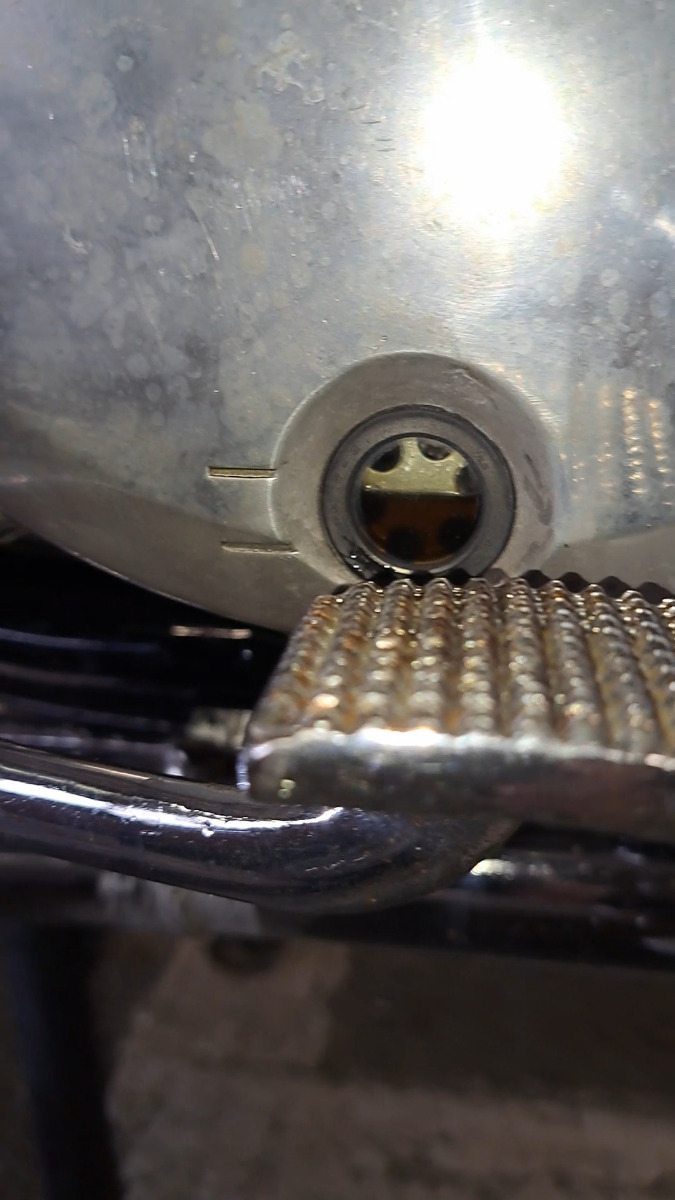

I might have a litte oil in the sump that is because after first oil-change that was done 200miles after rebuild i changed filter and filled 3,7 liter.
Then a few days ago (i have now done almost 1000 miles now) when checked oil it was covering the sightglass.I then sucked out 2,5 deciliter oil so i can see the oillevel . It is now at the top marking in sightglass .I usually dont ride up in the red sone but have done some test rides to se if the engine performs as i should.
It is mostly under hard aceleration the light comes on when rews go into red zone.

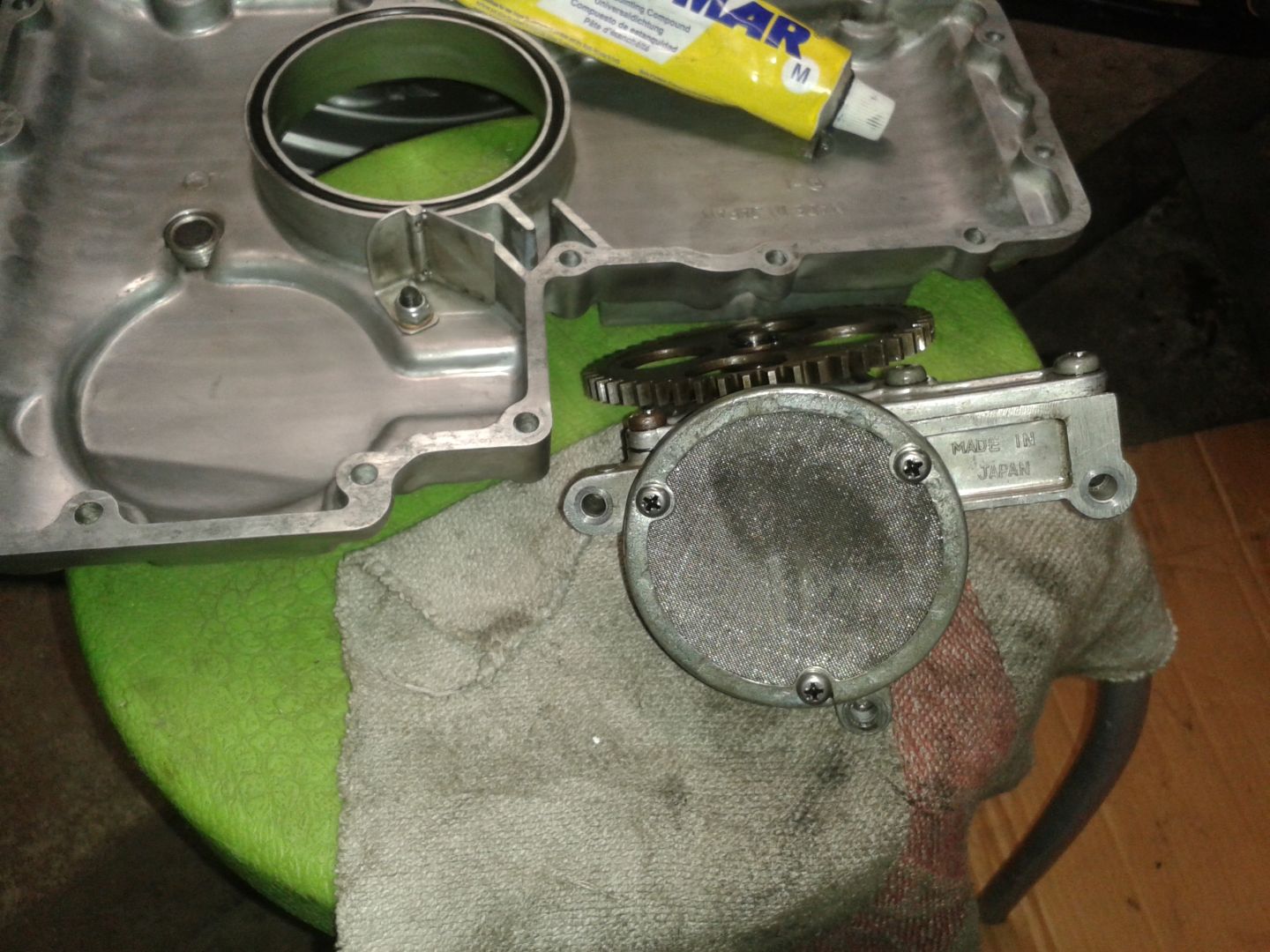

I had replaced the o-ring and the screen on the oilpump this winter.I tested it just by holding over the output hole and turned the sprocket and it gave
very good pressure so i did not open it to measure the propeller clearaces .Also if i had opened it i had to buy new gasket and did not have time for that. The old screen was clean no debris and sump was also clean.Im not sure if i have new or old type pump, but think i have new because of the look of the screen .I know the z1 had a screen that had 3 screws this pump has a press on screen.
Update just checked a vid i took vhen checking oil 2 days ago and the level is now between the markings on the sightglass so it is mayby to little oil when hard accelerate.I wrote that it was at the top mark but it is lower

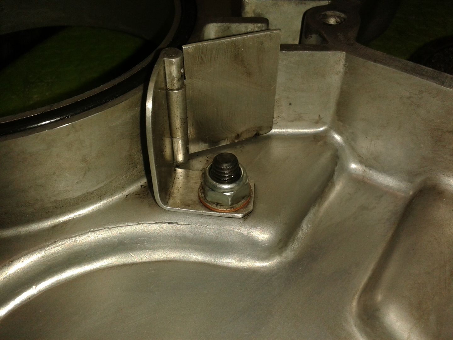

If the light is only coming on under very hard acceleration the cause may simply be due to oil surging to the back of the sump and away from the oil pick up .
This is a common occurance in that situation or drag racing etc and the fitment of an oil pan gate is the cure.
Your oil level is fine but i personally like to keep it at the upper mark when cold.. ( leave the bike overnight for the oil to drain back down and cool before checking the level).
Last edit: 23 Jun 2024 16:15 by zed1015.
Re: Normal for oil pressure lamp going on on the kz900 ?
23 Jun 2024 16:28
Under hard acceleration the oil sloshes away from the oil pump screen.
There is a swing door mod/fix to prevent this oil starvation situation.

So that is what that swingdoor is for ! i saw steve posted a pick in a tread earlier. I have now cofirmed it is only when accel hard and the rews go up into red rpm zone the lamp turn on not if going slowly.Before i dicover that the lamp was going on i had drained 2,5 deciliter oil because the sightglass was full .I will put back 2 deciliter .I filled total 3,7 liter on last oil and filterchange.
