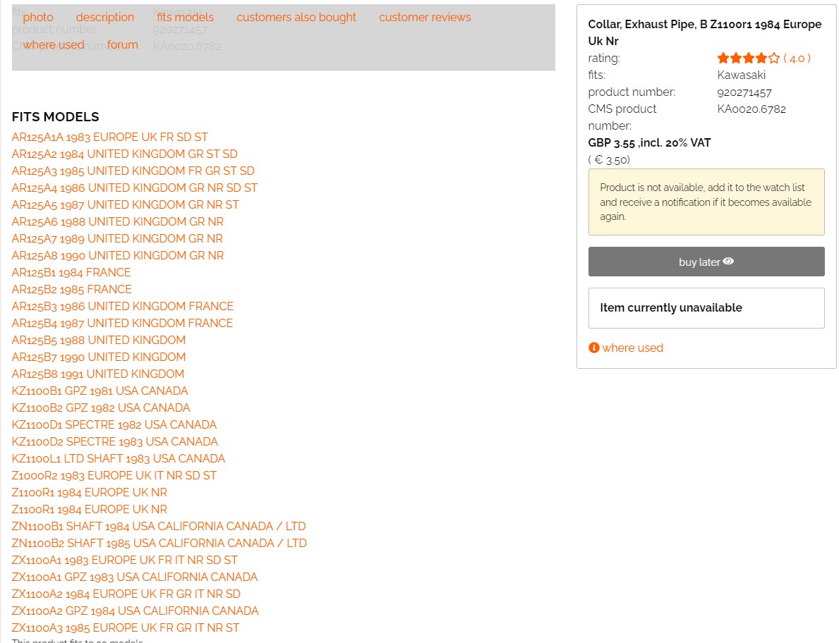

21 Jun 2024 12:58No, they may use the same part number on different models (see list in my post) but it will be the same part used across the rangeThanks for the correction! I had a typo in my original post.
The part number I am looking for is: 92027-1457. Seems to be unavailable at all of the online part places. I’ve bought a couple from ebay, but keep getting the wrong part. Did Kawasaki use the same part number on different parts?

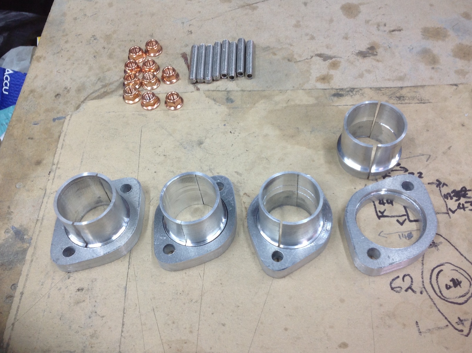

If you know anybody with access to a lathe you could bet some knocked out (I made mine from thick walled alloy tube then cut them in half)
