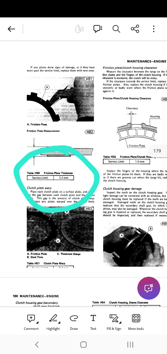

Hello guys, does someone has the thickness of a friction disc of a kz750 4cylinders?! Mine have 3.7mm ..

81-KZ440-D2.

Thank youuu!! Do you know how much mm when its brand neww ?!

It varies depending on brand. It could be anywhere from 3.55-3.85mm

I appreciate!! The bike has 75 000km with original clutch!! All is new, except the clutch and I’m very surprised about the « wear » of this one !!
