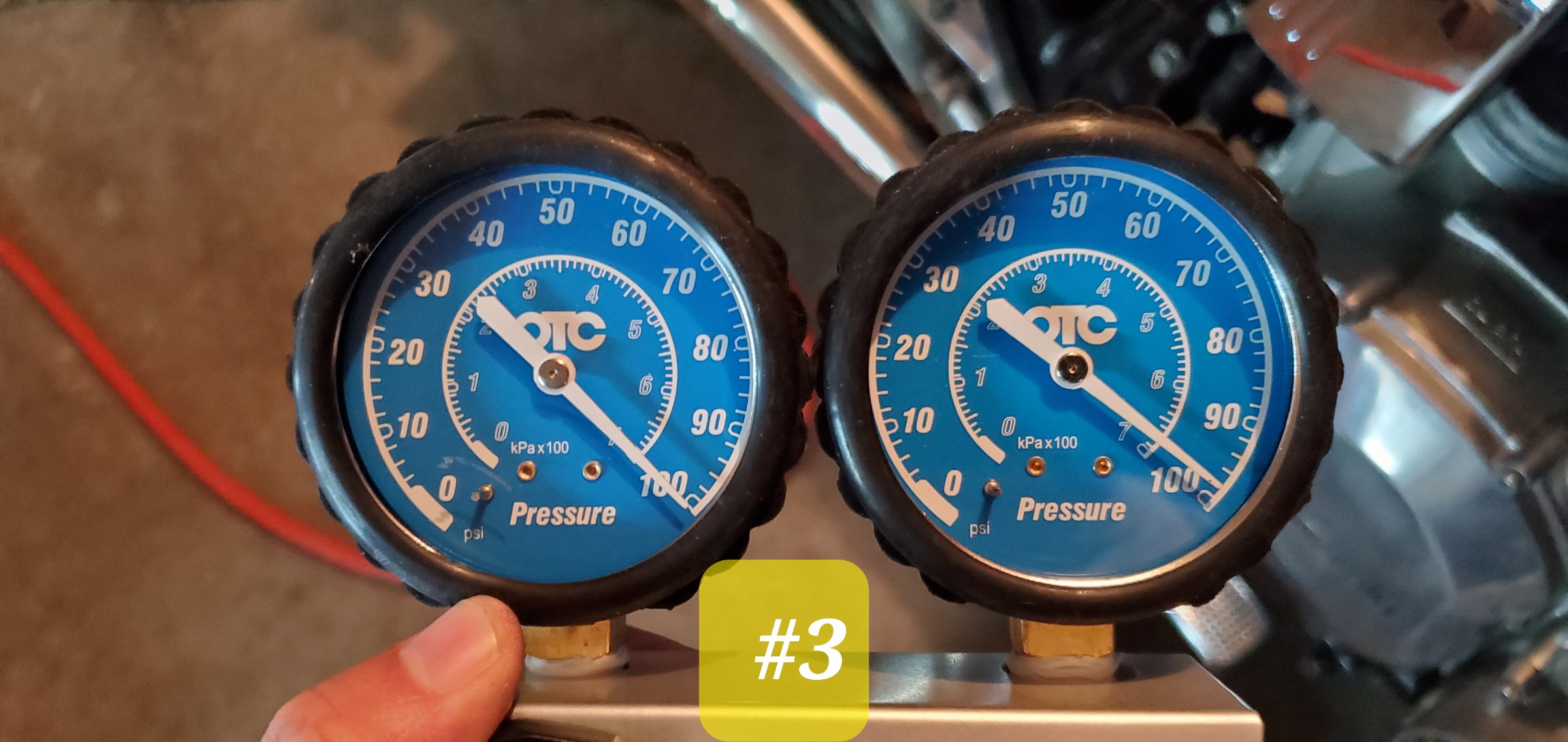

I ran compression and leak-down and it wasn't bad, the intake and exhaust were silent but you could feel it puffing through the crankcase vent, so to me that says rings. Compared to the other cylinders, it was lower (photos).
