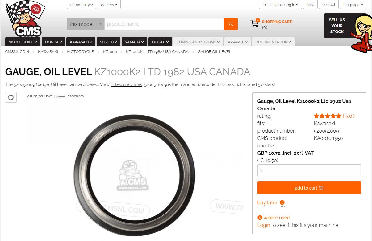

If needed such as if the seal is bad or not very tight, you could get a replacement sight glass with new seal. I've seen the part listed at various places. Partzilla has a photo w price and it was used on a lot of models, including a number of current models, so it should be readily available.
ps: z1enterprises svcks. maybe the change there was inevitable, but still. everybody calls that part a sight glass. Kawasaki lists it as an oil level gauge. z1 lists it as a "window", so you have to hunt for the darn thing.

Re: "J" clutch cover question
07 Jun 2024 06:31

07 Jun 2024 06:58 - 07 Jun 2024 06:59Yes! Z Power UK have genuine at around £25 and pattern for a fiver if your original one is too mullered to reuse.
Oil sight glass: Z-SERIES (GENUINE) (z-power.co.uk)

07 Jun 2024 07:00Always nice to have a plan "B" if it ends up being the 1% that didn't go to planYes! Z Power UK have genuine at around £25 and pattern for a fiver if your original one is too mullered to reuse.
25 Jul 2024 04:32Thanks Clay, if req Z-Power do an OE replacement for £25 (would probably cost that to ship from where you are) if I'm lucky (and careful) I should be able to re-use what I haveEasy to do Wookie!! I do it all the time on the earlier thru 1980 covers but the sight glass is different and came in different styles of backer metal plate. Have a few genuine ones but You live sooo far away, ha.
