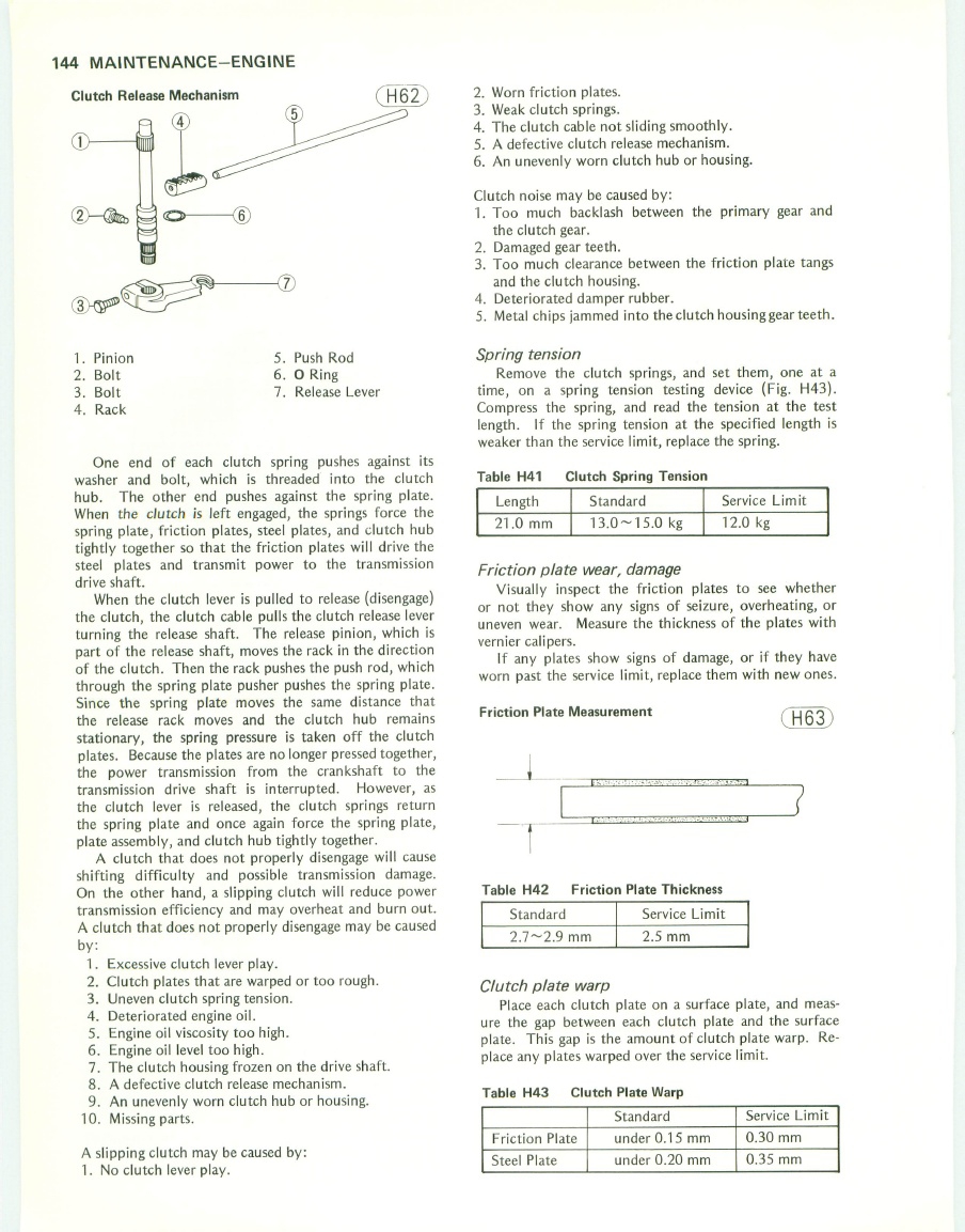

Your clutch release mechanism gear isn´t attached to the clutch push rod gear.
Try to get the KZ200 service manuals from the file base i have uploaded a long time ago.
