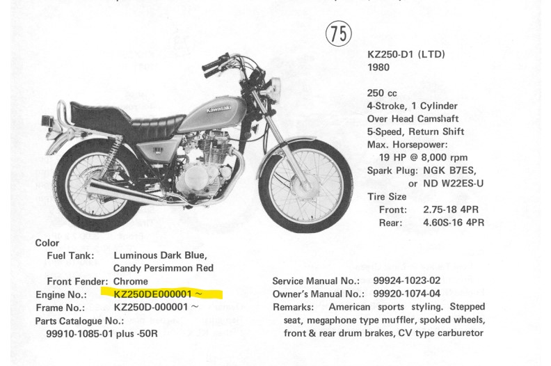

 I thought it was a 1980 kz250 ltd D1 but I might be wrong, I have the the service manual for the single cylinder kz250s but it doesn't show this code on the back to identify it?

The D2 starts from KZ250DE019501
