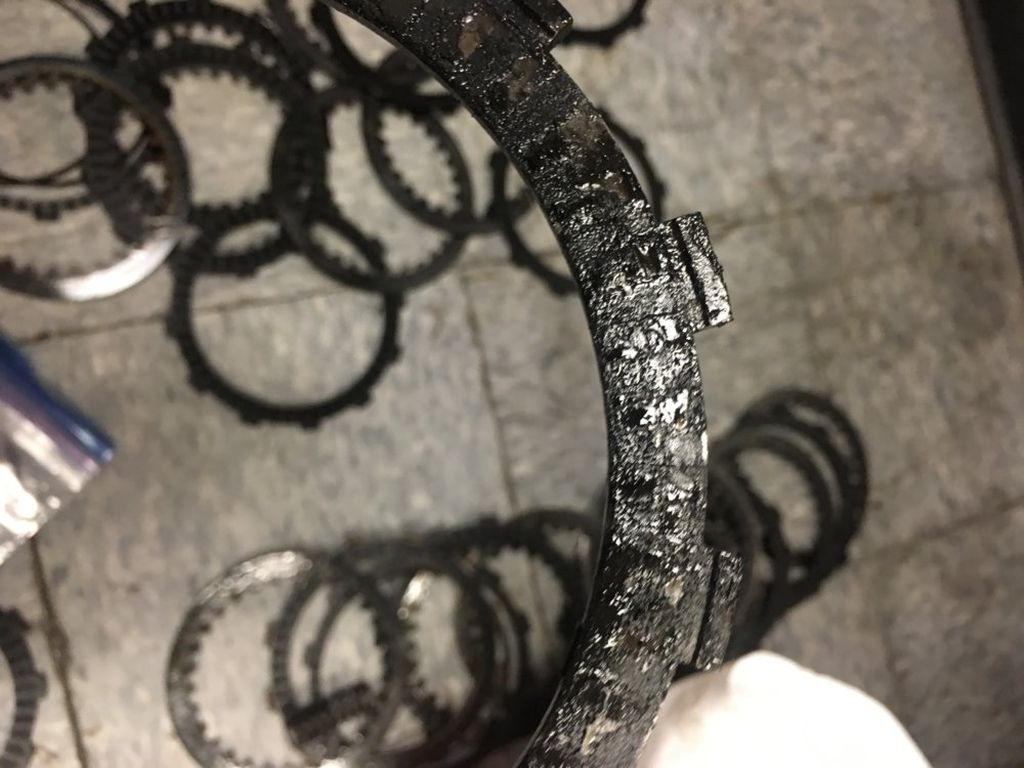

We won't use Rotella T6 5w-40 in a bike again. Clutch & tranny feel grew noticeably worse over the course of 3,000 miles in our ST1300A. Changed it early because of that, before we were even aware of the issues documented elsewhere developing. We've had zero problems with Rotells 15w-40 dino.
It was the pic of the ST1300 wet clutch plates that trusted forum user & ST1300 guru 'IGOFAR' posted in the third(?) linked thread in the OP that gave us pause, and the only reason we started this thread.

That clutch plate looks to be disintegrating. Not the common glazing problem that occurs with clutch plates when friction modifiers in an oil damage the friction material.
Did the guy on the forum collect an oil sample and send it in to Blackstone for analysis? I certainly hope so. Without science behind the investigation, all we have is supposition and opinions.

12 May 2024 05:55Will ask.
