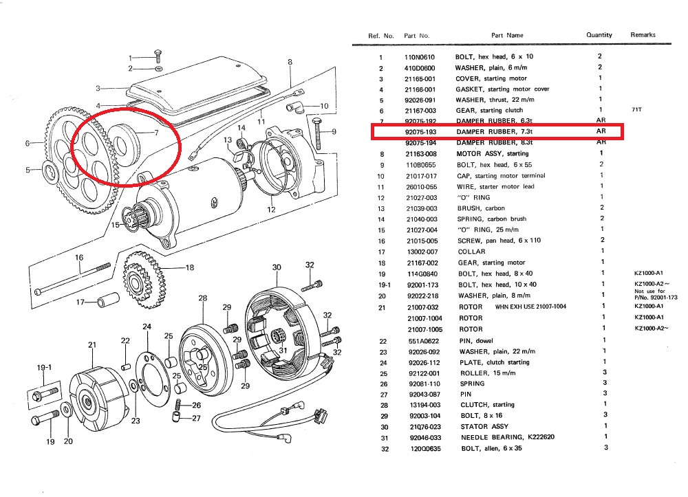

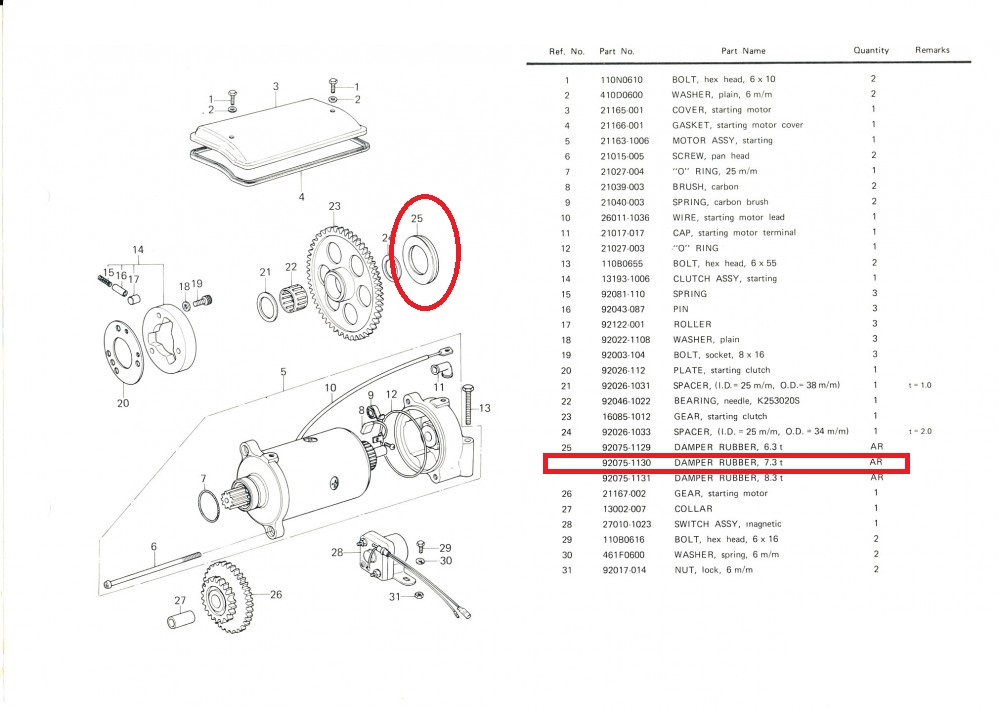

Can anyone tell me the difference between damper 92075-193 and 92075-1130 both are 7.3mm thick I seem to remember it may have to do with the ID of that damper. I need 902075-1130 which is the middle damper. I have two of the 8.3 dampers but I would like to get the proper one. Yes I could try to sand the edges down a bit but trying to avoid it. Part 920785-193 is a 7.,3mm damper but is there a difference in the ID. 92075-1130 has a 34mm id. If anyone can measure the other let me know.

damper 92075-193 is for the Z1 engine and 92075-1130 for the Z1000J/GPZ 1100 engine.

The dampers for the later engines with dished rotors don't fit as they have a larger hole in the center .
You need one from an earlier pre MK2 engine with small rotor.
It's an easy job to reduce the width by lapping them on a flat surface with some wet and dry..

Per Service Bulletin 74 Z-24:.
#92075-193 superseded #92075-187
#92075-187 I.D. is 31mm
#92075-193 I.D. is 36mm
Both are listed as 7.3mm thick.
The changes were made concurrent with dyno rotor, copper shim washer and starter gear mods.

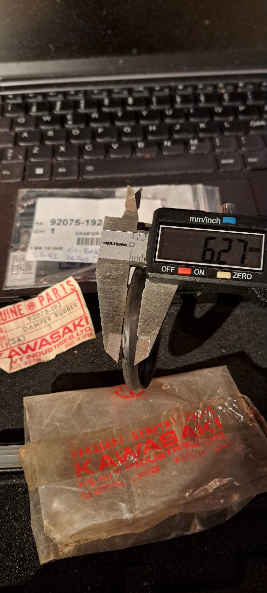

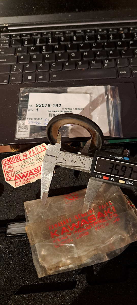

Here is a pick i took of damper today. the veriner is not 100% right ot shows a little less so its 36mm

08 May 2024 06:45Close enough. There's a little slop in the fit anyway. They don't have to be precise.Here is a pick i took of damper today. the veriner is not 100% right ot shows a little less so its 36mm
