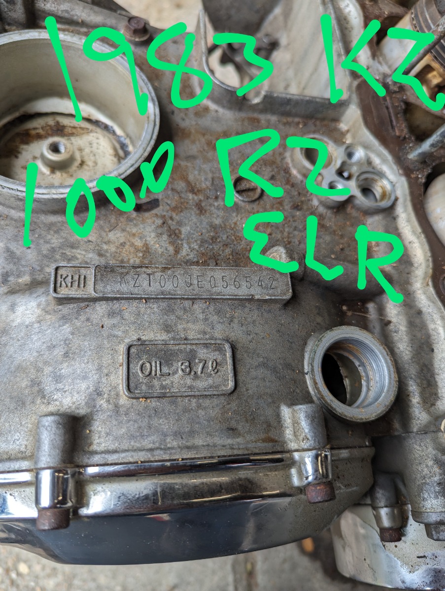

In tearing down the engines that I got with my bulk parts purchase recently, I noticed that one was an 83. I was in the process of completely disassembling the engine. When right before I was going to split the halves, I decided to check the engine number again. I had already identified it as an 83 but upon further inspection I noticed it was the 83 ELR R-2. I loosely buttoned it all back up seeing what low production numbers they were. What I'm wondering is, should I sell, or trade for more parts I need or cannibalize everything that I can use for my other builds? The problem is that there's not much I can use out of that engine. I believe it has a good crank and was wondering if that crank will work in the earlier models. I'm concentrating on a 73 Z1 and possibly 76 kz1000. I doubt I'll do an ELR build. The reason is in that cache of parts, I got two powder coated frames and one was a 73 and the other was a 76.Thoughts or options:)

I am interested in learning where you found info that indicates the engine number KZT00JE056542 was used on the the 1983 KZ1000 R2. I am not saying it is not but I have not been able to find any info to indicate such.

Again... not sayin' that yours isn't an R engine... but my KZ1000R2 had a black set of cases and clutch cover.

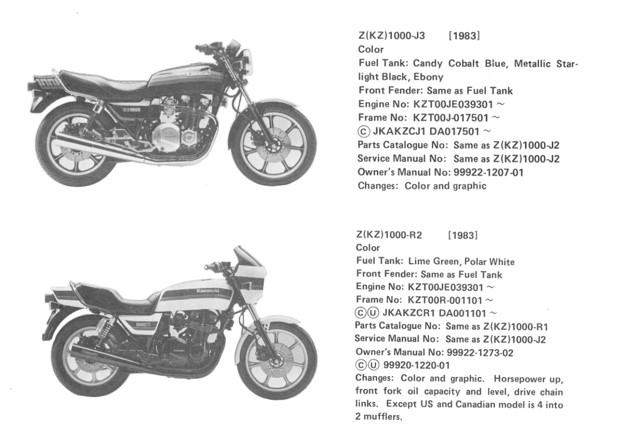

It looks like the R2 and J3 share the same engine number range - as it's not black it is likely a J3

Yep, I'll definitely double check my info. If I remember correctly it was chromed and not a black engine. But that was last week when I tore that engine down and I've torn two down since then....that will make my decision of what to do with it much easier If it's not an R-2

I have found some info - not claiming it is correct - that indicates your engine number is included in the possible range that came stock on a 1986 1000 P5.
Year & Model '86 KZ1000-P5:Police
Color(s) Jet White
VIN Range JKAKZCP2vGB503101 - ?
Engine No. Range KZTOOJE047501 - ?
Engine No. Location RH top crankcase, below carburetor
Cylinder Mark 0.998L
Cylinder Mark Location Front RH corner
Engine Type 4-stroke, 4-cylinder, DOHC, Air cooled
Bore X Stroke 69.4 X 66.0 mm
Compression Ratio 9.2:1
Maximum HP 80 at 8000 rpm
Maximum Torque 7.7 kg-m at 7000 rpm

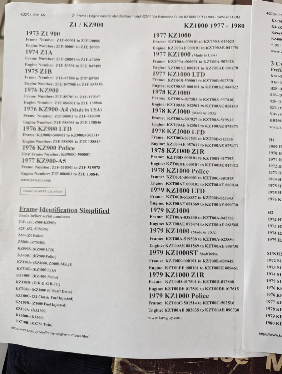

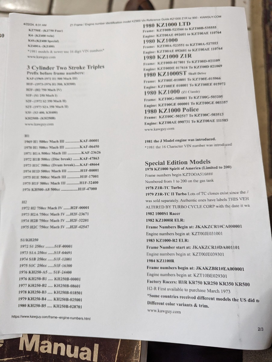

Thank you so much guys, my decoding error. I also figured the cam chain was going to be an issue as well. I'll probably just use it for trading parts. This is what I used to decode. I see now that this data was incomplete. It stopped in 1980.

Thanks for posting the listing you were using. I do not think I had seen it like that before. I tend to learn something new each time I visit here!
