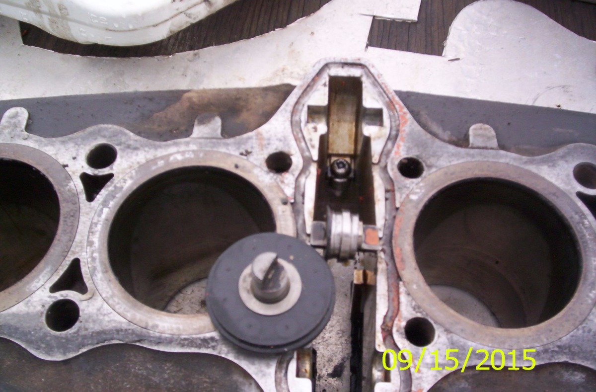

Hello everyone, how often do you adjust the timing chain tensioner? Thanks

If it a factory tensioner, never.

I recently assembled the engine, it's a KZ1000, and the tensioner is one of those that you adjust by hand.

Check every 4-800 miles unless it's noisy and not new. If old the rollers and guide may be worn out or broken.
