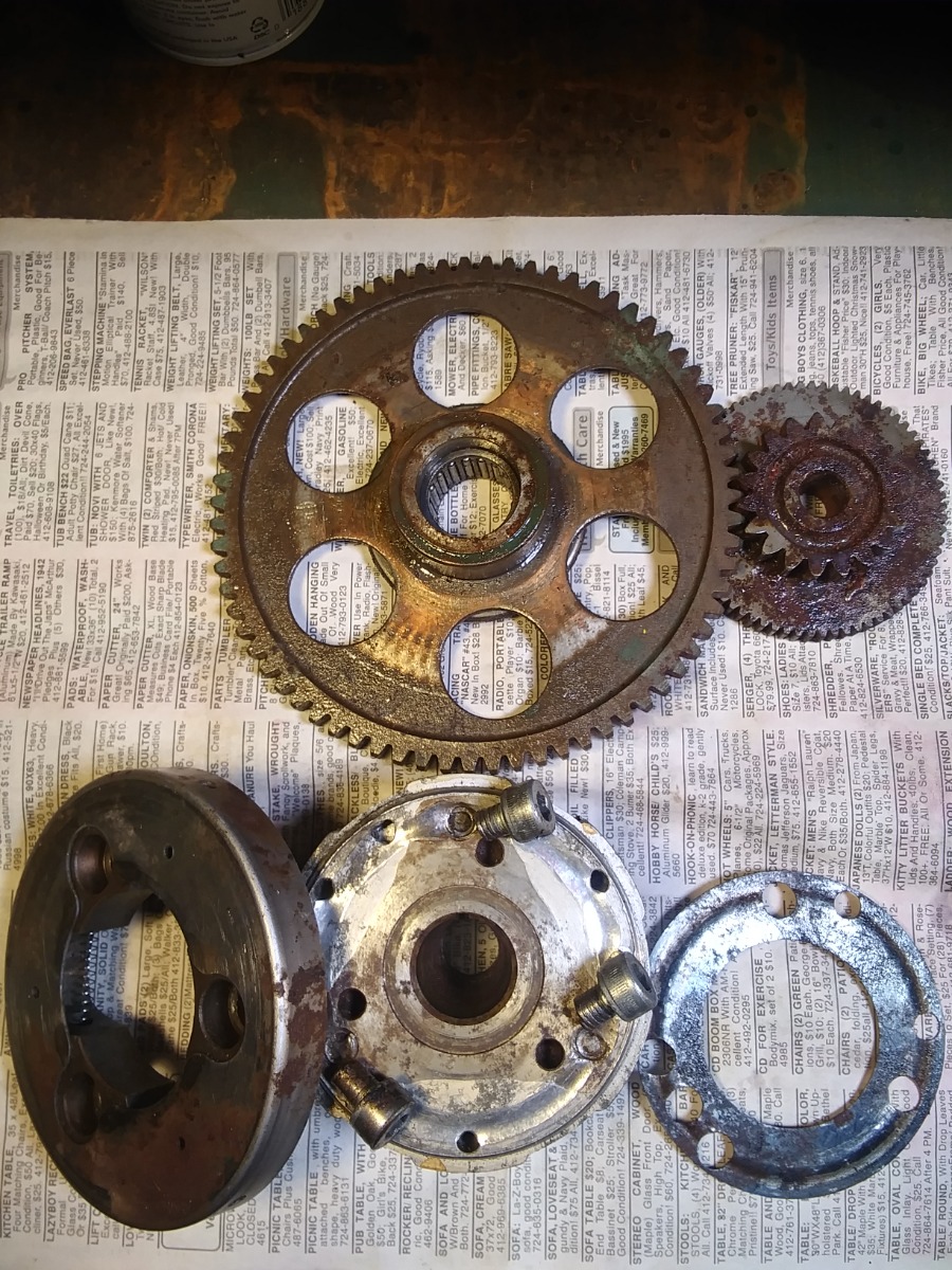

Thanks again to all for the help and great info. You guys really know your Kaws. Anyway the cam sprockets are 32 teeth so I'm quite certain it's a MK 2 crank. But after another look at the original starter assembly that I still have, the three bolts that hold the starter clutch to the rotor are sheared off. I think they tried to use that assembly with the larger motor (1327cc) and crankshaft. and it failed. I was then given the option of an outboard starter, or to kick start it. Anyway hopefully a MK 2 starter assembly can be fitted. Also a pic of a heavy duty starter that Pogue Racing used to sell from there catalog back then, maybe there's some still around ??

12 Apr 2024 15:19Yes! You will need the MK2/ST starter clutch.Anyway hopefully a MK 2 starter assembly can be fitted. Also a pic of a heavy duty starter that Pogue Racing used to sell from there catalog back then, maybe there's some still around ??
