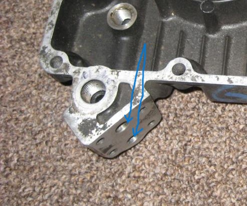

I picked up a Zephyr 750 oil pan for a project and noticed that there is no oil cooler line separating plug in the oil pan. Is this normal? For those who have a ZR7s oil pan installed on their KZ650/750 oil cooler conversions, is there a plug present? Reason I ask is that I noticed the oil cooler doesn't get as warm when using the Zephyr oil pan as it does when I use the GPZ750 oil pan (which has the 14mm plug). I don't see why oil feed would divert through the oil cooler if it can simply flow upward toward the head...

This question has caught my attention. I put an oil cooler on my 750E, using an oil pan with the cooler line ports drilled, but I didn't take note of this level of detail. I think the output line and return line ports must be separated, or there will be minimal oil flow through the cooler.
Checking the parts diagrams, there is no PN for a plug between the ports. Many times, Kawasaki doesn't sell parts that are integral with a base part. Can you make the missing plug? Otherwise, you may need to get a different pan.

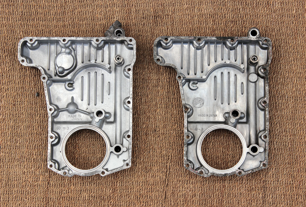

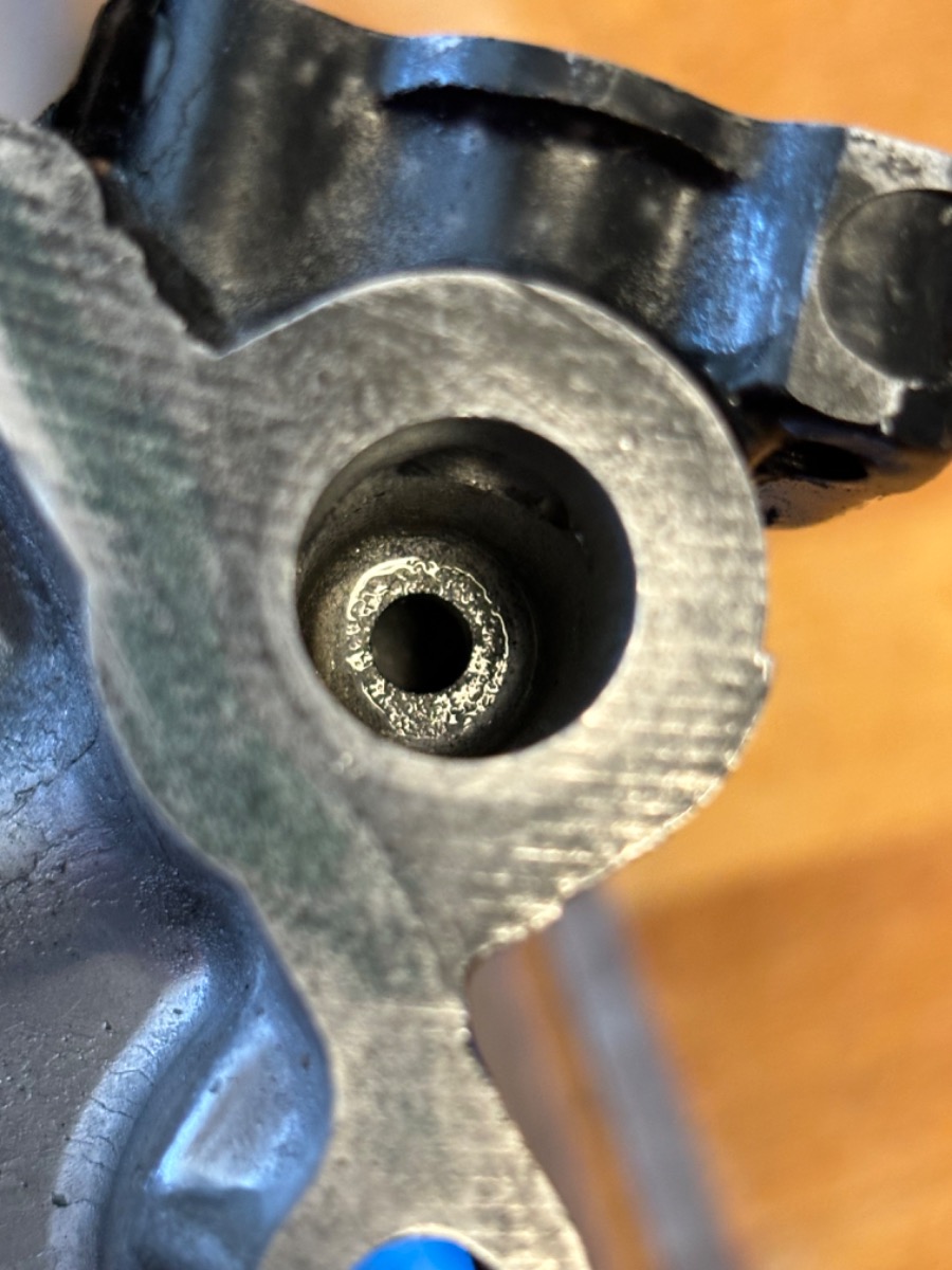

Looking back through some photos of my engine build, it seems that I used a ZRS oil pan as well. I can't remember, but the GPz's and L model bikes used an oil level sensor in the pan, and my pan doesn't have that provision, so...
Should I be worried?
Is the hole between the ports threaded? It doesn't appear to be in the photos.

08 Apr 2024 07:07 - 08 Apr 2024 07:08You are obviously getting oil to the top end (would have been obvious by now if not) does your oil cooler get hot after a long run ? if the answer is yes then I suspect all is as it should be and the reduced size hole between the ports redirects a predetermined portion of the oil flow through the cooler, not all of it - I would be cautious of blocking the by-pass hole as the cooler circuit doesn't look capable of dealing with 100% of the oil flowLooking back through some photos of my engine build, it seems that I used a ZRS oil pan as well. I can't remember, but the GPz's and L model bikes used an oil level sensor in the pan, and my pan doesn't have that provision, so...

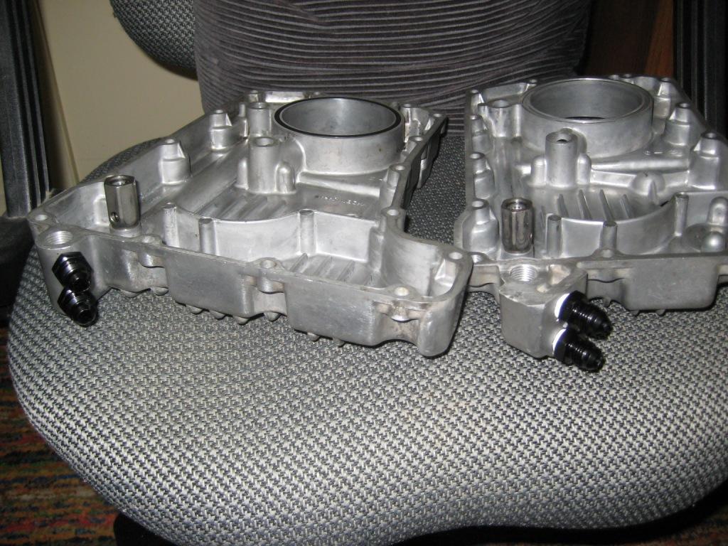

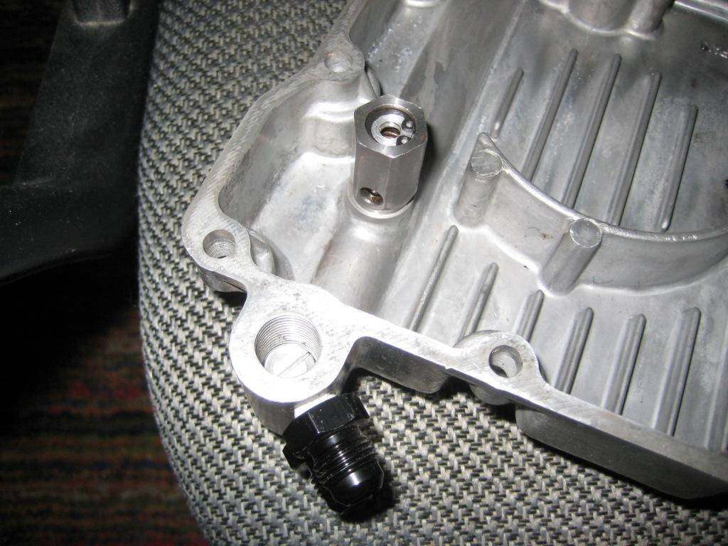

Leaving the plug out of the later series engines might have been a cost cutting measure, eliminating a part plus a machining and assembly operation. Kawasaki must have come to the conclusion that having a restriction in that circuit was good enough for the correct operation of the oil cooler.
Its probably not as "efficient" as having the plug in there but I don't think its a cause for concern.

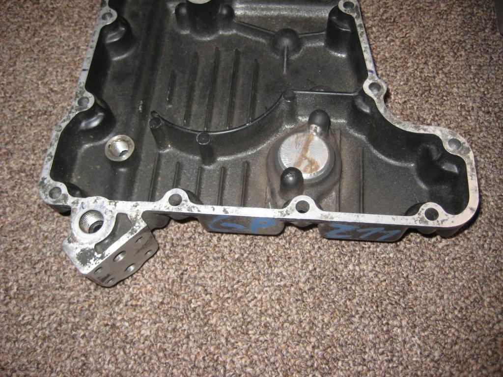

The GPZ pans with the oil level sensor always seem to leak, mine leaked even after changing the O ring. I made a plug for it and had it welded shut.
Recently I converted a 650 oil pan to run a oil cooler from that front oil feed galley.
650 and 750 Spectre (sensor hole not machined)
650 modified (custom diverter plug)
GPZ750 with sensor plug welded in.
On the later oil pans they left all the cast features in but eliminated the machining. The Spectre does not use a oil cooler so there are no machined holes to attach the fittings (no diverter plug)
I plan to run a much larger oil cooler than a stock Kawasaki unit so I opted to run a diverter plug emulating the GPZ pan.

Just out of interest what size are these holes in the stock pan (you appear to have opened them up for your fittings) they look kind of small in the picture to carry the full flow (just my opinion)
Last edit: 08 Apr 2024 09:05 by Wookie58.
- Injected
- Posts: 1584
- Thanks: 1131
Re: Zephyr 750 , ZR7S Oil Pan Question
08 Apr 2024 12:10That is a old picture, I already tapped those 1/4NPT and have -6AN fittings attached. I do remember I had to drill the proper size for that pipe thread so they were slightly smaller but I can't remember by how much, maybe .030"-.040" oversize. Maybe those holes were about .40" diameter.
The oil feed on the GPZ pan I believe takes a M14 plug. I put a 9/16-18 plug in mine because I had that tap.and it seemed really close size wise.
The restrictions thru fittings only increase pressure in that localized part of the oil circuit. I believe the ID of a -6AN fitting is .28" and the hose size is a nominal 3/8" ID.
