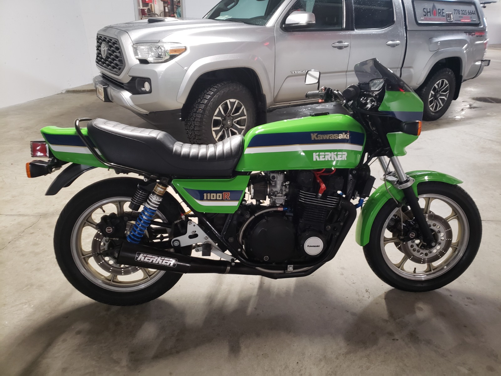

26 Mar 2024 14:51Nice...did you recently purchase that bike from a fellow by the name of Glenn?Thanks to you all for the prompt reply. As stated, very helpful forum.// Craig

McDroid.....indeed I did. Bought it a few years ago actually when I was in Vancouver. What do you know about the bike?//Craig

26 Mar 2024 16:57 - 26 Mar 2024 16:59Sweet bike...he took good care of it and he was instrumental in me getting information on that model (I collect info on different models). I do remember that he had issues with that tank leaking fuel via some pinholes...which I think he resolved by brazing those holes...and then had the tank repainted. I am surprised he sold it, actually...but he does have (had) a 1400 Concours. It will be wise of you to print off or purchase both the KZ1100R supplemental manual (Kawasaki part number 99924-1038-02) and the base manual (Kawasaki part number 99924-1026-03). There are a few idiosyncratic things about your model, e.g. carburation. Nothing scary. Both are still available on eBay. If you ever tire of the bike...keep me in mind.McDroid.....indeed I did. Bought it a few years ago actually when I was in Vancouver. What do you know about the bike?//Craig
