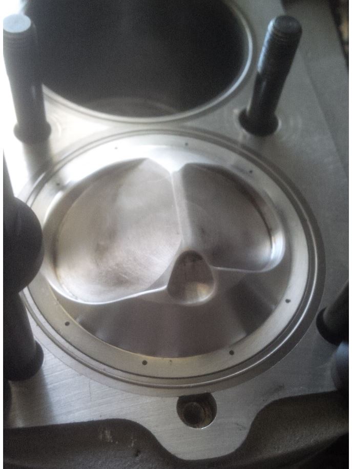

09 Mar 2024 09:42 - 09 Mar 2024 09:49Sorry to burst your bubble but anything 1327cc and above requires a big block which does not have any provisions for cooling like a stock block does. Even "cheater" blocks have minimal cooling fins on the block and no pass thru holes around where the liners are pressed in.Thank you.
I have almost zero interest in a dedicated drag bike.
But maybe a 1500 could make a bad ass mountain road sleeper?
Above 1428 they require much higher lift cams than are recommended for street use to run properly. Even the bigger RS40 flat slides are on the small side for a 1500 engine build.
1500cc is a 85mm piston, it pretty well max'd out the area on a big block. MTC does sell pistons out to 89mm but I believe that are for billet blocks only.
Below is a 85mm piston in a big block :
With small cams (.435") and carbs that 1500 would run like a tractor. They don't sound right unless they are set up for full air flow potential.
Guys do run 1428 big blocks on the street but they are not meant for that so there are bound to be issues. There are all kinds Pro Street bikes out there but they are mostly built for bragging rights.
