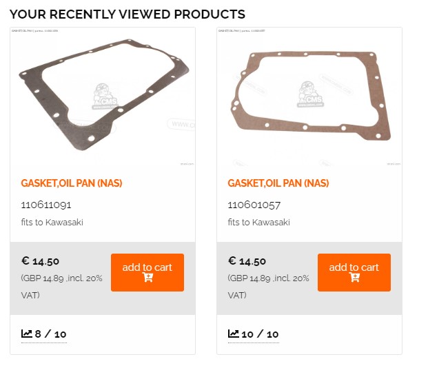

Re: Oil Pan Gasket For Gpz550?
04 Mar 2024 08:22
I don't know where in the world you are but CMNSL shows a supersession to an 091 number. Partzilla also show in stock
04 Mar 2024 09:28
I'm in USA.
I have had terrible luck with partzilla. If they do ship it takes forever and many times they cancel the order and refund because no stock.
Would I be searching for 11061-1091?

04 Mar 2024 10:06According to CMNSL yesI'm in USA.
