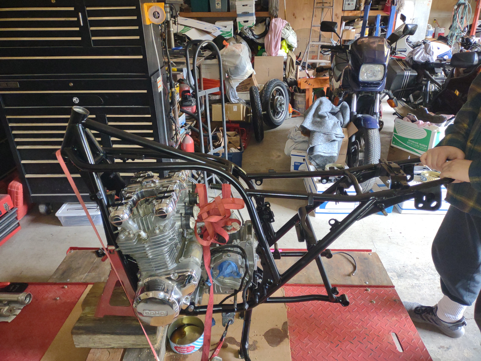

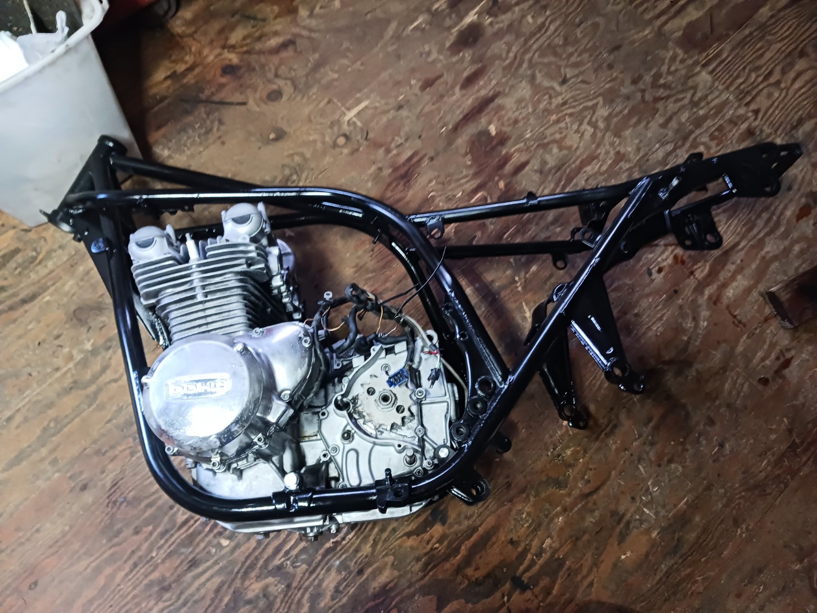

I'm starting another relove of a 1978kz1000a.I for the 1st time installed the engine on its side. I have read many times this being done. It's worked out great doing it myself.

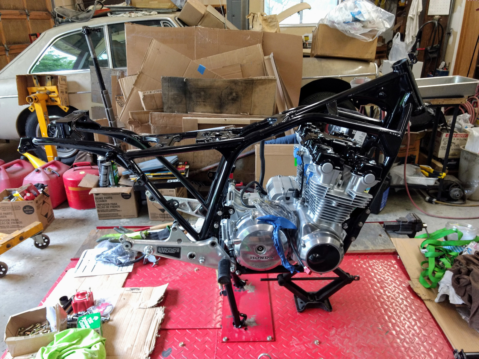

We have done at least 6 or 7 bikes installing the frame over the engine. It works really well if there's a center stand already on the frame.

Why the center stand?
- Kelly E
- Posts: 584
- Thanks: 492
Re: Engine install kz1000
03 Mar 2024 09:51Why the center stand?
Once the frame is on the motor we can pick it up and put it on the lift table with a jackstand in the front. Then it's ready to start installing parts.

I know it’s a radically different engines and weights, but went over the same thing with my brother and his YZ250.
He was trying to figure out some Rube Goldberg contraption to balance the bike and slide the engine in.
I was like, “Do you have a spare piece of cardboard or rug to prevent the engine cases from getting scratched up?”
I think the engine weighed around 30# and the frame maybe 7#?
Much easier to maneuver the light frame around the heavy engine than the other way around.
